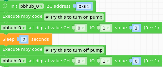

and also the analog value reading i can read on port c from this device.<br />
I thougt first i must plug the PB.HUBUnit in Port B, but this seems a wrong suggestion.<br />
On port B it tells me always the PB.HUBUnit cannot found and does nothing? Confusing.</p>
<p dir="auto">so for the first step, im happy and thanks.</p>
<p dir="auto">So can you maybe Explain me, or just tell me, is it ok, to use 2 Pumps on this port C with the HUB and Switch them eventually Both on, or use them so much Power that i can destroy the Port or Hole Device with this action ?<br />
How do i calculate this, or what is the Maximum for this Ports.</p>
<p dir="auto">.. on my next step i wanna a a weight Unit to confirm the moisture value of the capacitive sensor..</p>

<p dir="auto">looking through the source code of UIFlow2 I don't think any of the Port B units are prepared to be used through PBHub (yet).</p>
<p dir="auto">That said, you could try the following: Only add the PBHub unit, connect the watering unit to channel 0 and then try below commands to turn the water pump on for 2 seconds.</p>
<p dir="auto"><img src="/assets/uploads/files/1721929652456-uiflow2pbhubwatering_20240725.png" alt="UIFlow2PbHubWatering_20240725.png" class=" img-fluid img-markdown" /></p>
<p dir="auto">Please note: I do not have the necessary M5Stack hardware to actually test this myself, so I could be wrong.</p>
<p dir="auto">Thanks<br />
Felix</p>
