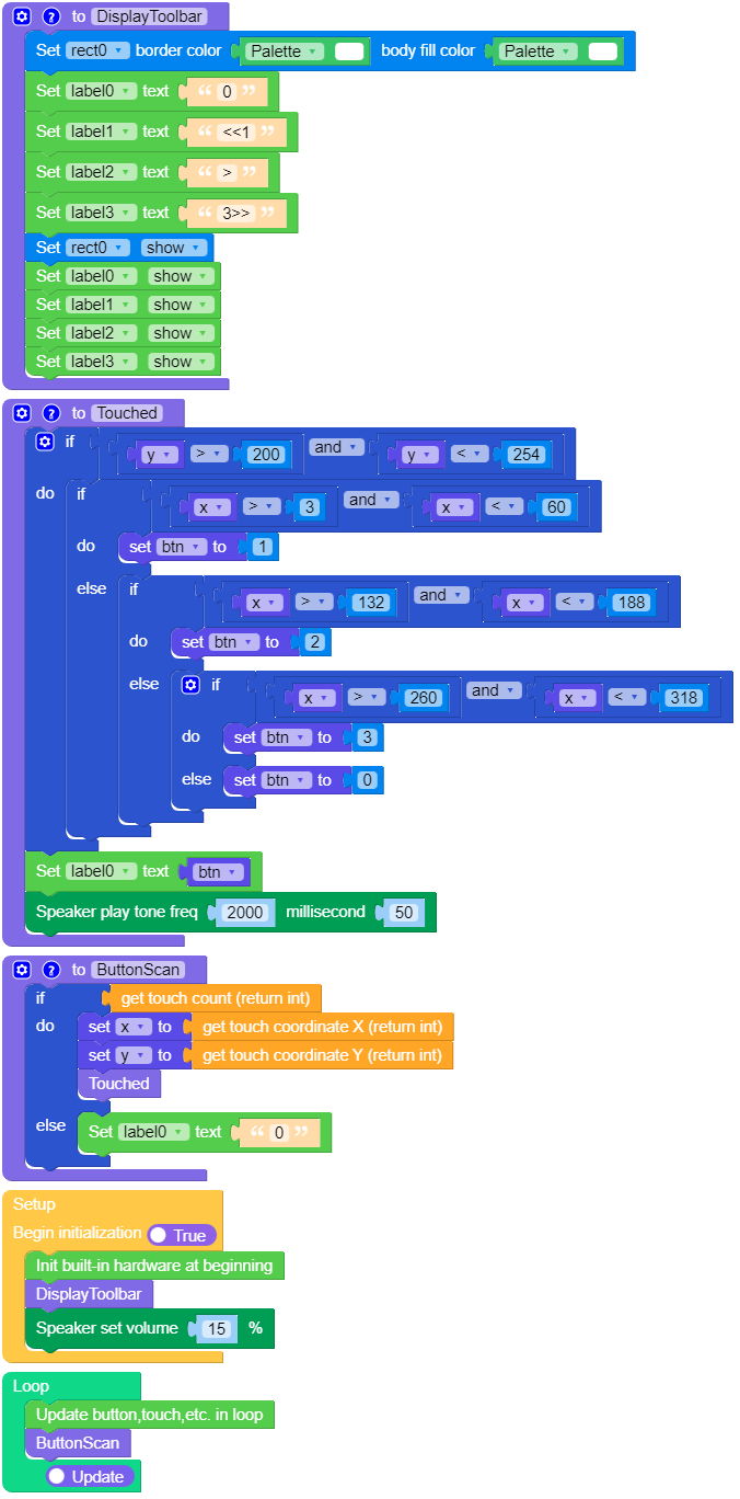

<?xml version="1.0" encoding="UTF-8"?><rss xmlns:dc="http://purl.org/dc/elements/1.1/" xmlns:content="http://purl.org/rss/1.0/modules/content/" xmlns:atom="http://www.w3.org/2005/Atom" version="2.0"><channel><title><![CDATA[Making Buttons and other things in UI Flow 2 for a Core S3]]></title><description><![CDATA[<p dir="auto">I have made some rectangles and label for those rectangles.  How do I make them buttons that will pass compile.  Is there a way to make the rectangles, buttons and if so, how?  If not, how do I make a button that will work?  My project needs to press a button to go to the next screen.  I am very new to this and I have no idea how half of this even works.  I can't find anything on YouTube, but I suspect I am just not typing in the correct search criteria.  If there are some tutorials for UI Flow 2 on YouTube please let me know.<br />
Thanks for any help!!</p>
]]></description><link>https://community.m5stack.com/topic/6677/making-buttons-and-other-things-in-ui-flow-2-for-a-core-s3</link><generator>RSS for Node</generator><lastBuildDate>Sun, 17 May 2026 08:34:57 GMT</lastBuildDate><atom:link href="https://community.m5stack.com/topic/6677.rss" rel="self" type="application/rss+xml"/><pubDate>Sun, 04 Aug 2024 21:53:40 GMT</pubDate><ttl>60</ttl><item><title><![CDATA[Reply to Making Buttons and other things in UI Flow 2 for a Core S3 on Mon, 05 Aug 2024 21:51:22 GMT]]></title><description><![CDATA[<p dir="auto"><a class="plugin-mentions-user plugin-mentions-a" href="/user/robertof" aria-label="Profile: Robertof">@<bdi>Robertof</bdi></a><br />

Best regards.</p>
<p dir="auto"><img src="/assets/uploads/files/1722893822339-uiflow2_block_3buttons.png" alt="uiflow2_block_3Buttons.png" class=" img-fluid img-markdown" /></p>
