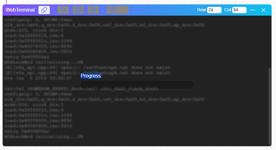

<?xml version="1.0" encoding="UTF-8"?><rss xmlns:dc="http://purl.org/dc/elements/1.1/" xmlns:content="http://purl.org/rss/1.0/modules/content/" xmlns:atom="http://www.w3.org/2005/Atom" version="2.0"><channel><title><![CDATA[Download shows &#x27;Progress&#x27; but nothing happens]]></title><description><![CDATA[<p dir="auto">Hi all, I am new to UIFlow and M5 Stack, I have done the Firmware flash using the M5Burner. Now using UIFlow, I can connect to the Serial Port, I can see the device sending default messages, then I press on Download, it shows 'Progress' but nothing happens. Can anyone please help?<br />
I have tried the Download button on the right bottom of the UIFlow, this then shows Device Disconnected, but the webpage shows USB connected?</p>

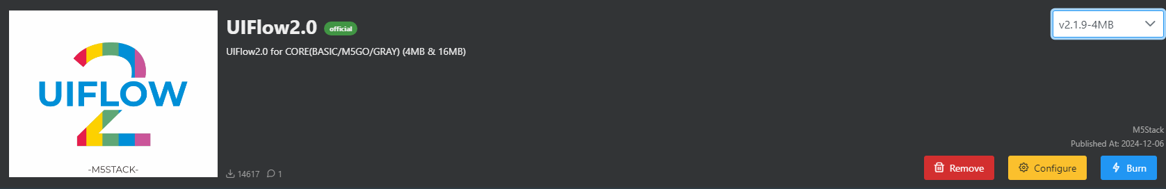

<img src="/assets/uploads/files/1734412222730-uiflow2burn.png" alt="uiflow2burn.png" class=" img-fluid img-markdown" /></p>

This function is available only after the UiFlow2 firmware has been burned. Have you burned the UiFlow2 firmware?</p>
]]></description><link>https://community.m5stack.com/post/27488</link><guid isPermaLink="true">https://community.m5stack.com/post/27488</guid><dc:creator><![CDATA[kuriko]]></dc:creator><pubDate>Tue, 17 Dec 2024 02:01:06 GMT</pubDate></item><item><title><![CDATA[Reply to Download shows &#x27;Progress&#x27; but nothing happens on Mon, 16 Dec 2024 07:37:46 GMT]]></title><description><![CDATA[<p dir="auto"><a class="plugin-mentions-user plugin-mentions-a" href="/user/nak750" aria-label="Profile: nak750">@<bdi>nak750</bdi></a> I have exactly the same problem. I tried to connect to my two devices (M5stack Core &amp; M5Stick2Plus, on three computers Win7, Win10, Win11. The port is visible and the data from the devices is displayed, but the launch and download do not give anything.  The terminal window displays the message "Progress" Please tell me please what exactly needs to be done to launch the program from UIFlow on the connected device?<br />
<img src="/assets/uploads/files/1734334656258-progress.png" alt="progress.png" class=" img-fluid img-markdown" /></p>

]]></description><link>https://community.m5stack.com/post/26020</link><guid isPermaLink="true">https://community.m5stack.com/post/26020</guid><dc:creator><![CDATA[nak750]]></dc:creator><pubDate>Tue, 06 Aug 2024 11:17:58 GMT</pubDate></item><item><title><![CDATA[Reply to Download shows &#x27;Progress&#x27; but nothing happens on Mon, 05 Aug 2024 17:43:18 GMT]]></title><description><![CDATA[<p dir="auto"><a class="plugin-mentions-user plugin-mentions-a" href="/user/nak750" aria-label="Profile: nak750">@<bdi>nak750</bdi></a> Have you installed the USB driver?<br />
