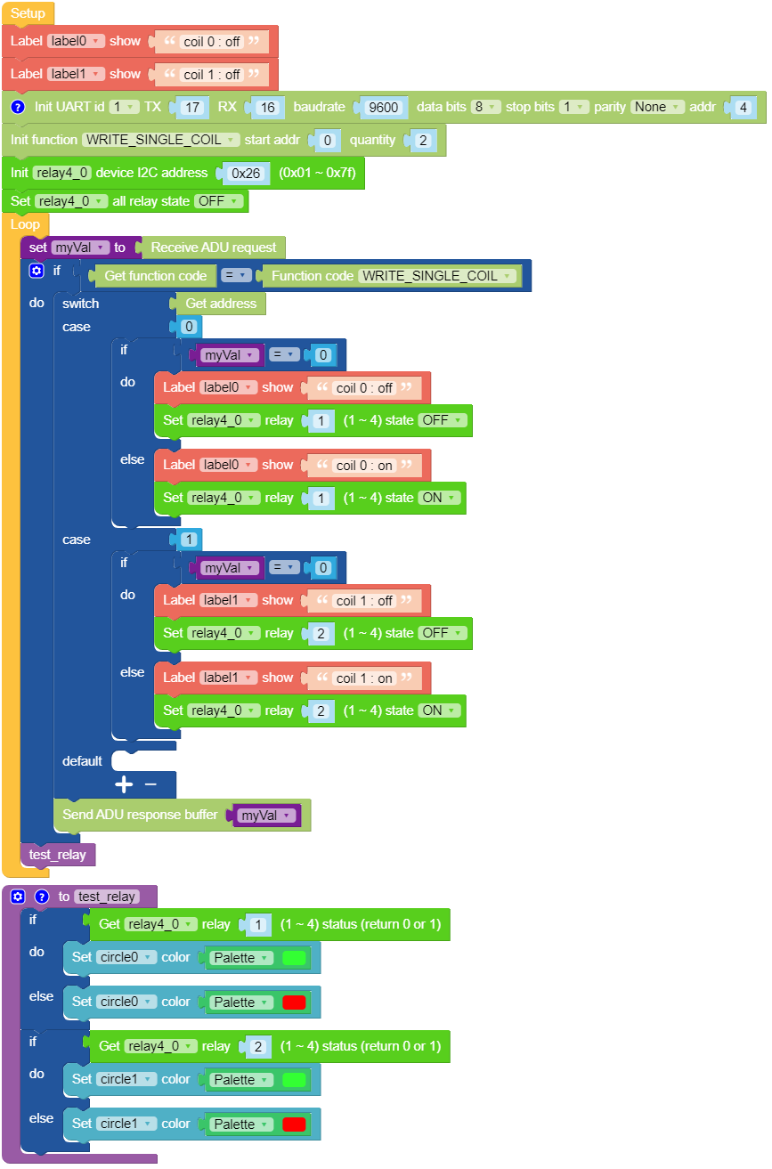

This has worked perfectly thanks to your help.<br />
Your comments helped me understand the code and adapt it to my needs.<br />
If there's any way to mark this post as resolved, I would appreciate it if you could let me know how to do it.<br />
I am very grateful for your help.<br />
Thank you so, so, so much.<br />
Roberto.</p>

]]></description><link>https://community.m5stack.com/post/26032</link><guid isPermaLink="true">https://community.m5stack.com/post/26032</guid><dc:creator><![CDATA[Robertof]]></dc:creator><pubDate>Thu, 08 Aug 2024 11:54:21 GMT</pubDate></item><item><title><![CDATA[Reply to Help 4-Channel Relay 13.2 Modbus on Thu, 08 Aug 2024 05:07:54 GMT]]></title><description><![CDATA[<p dir="auto">Hello <a class="plugin-mentions-user plugin-mentions-a" href="/user/robertof" aria-label="Profile: Robertof">@<bdi>Robertof</bdi></a></p>

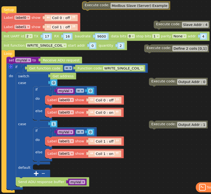

<p dir="auto">from what I can tell Modbus Slave (Server) blocks have not yet been implemented in UIFlow<strong>2</strong>.</p>
<p dir="auto">That said, please find below a Modbus Slave (Server) example in UIFlow<strong>1</strong>:</p>
<p dir="auto"><img src="/assets/uploads/files/1723093567585-m5stackmodbusslaveexample_uiflow1.13.6_20240808.png" alt="M5StackModbusSlaveExample_UIFlow1.13.6_20240808.png" class=" img-fluid img-markdown" /></p>
from m5ui import *
from uiflow import *
from modbus.slave.rtu import ModbusSlave
setScreenColor(0x222222)
myVal = None
label0 = M5TextBox(20, 31, "label0", lcd.FONT_Default, 0xFFFFFF, rotate=0)
label1 = M5TextBox(19, 69, "label1", lcd.FONT_Default, 0xFFFFFF, rotate=0)
label0.setText('Coil 0 : off')
label1.setText('Coil 1 : off')
modbus_s = ModbusSlave(2, tx=17, rx=16, baudrate=9600, data_bits=8, stop_bits=1, parity=None, slaveID=4)
modbus_s.function_init(5, 0, 2)
while True:
  myVal = modbus_s.receive_req_create_pdu()
  if (modbus_s.find_function) == (5):
    if modbus_s.find_address==0:
      if myVal == 0:
      else:
        label0.setText('Coil 0 : on')
    elif modbus_s.find_address==1:
      if myVal == 0:
      else:
        label1.setText('Coil 1 : on')
    else:
      pass
    modbus_s.create_slave_response(myVal)
  wait_ms(2)
</code></pre>
<p dir="auto">Thanks<br />
Felix</p>
