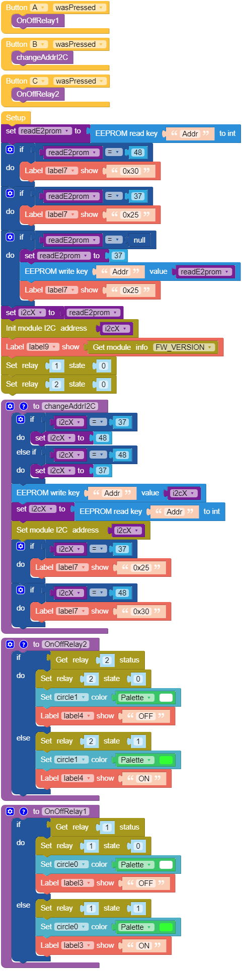

        Robertof @cryptospok

            • R Offline
              Hi @cryptospok .
              In my tests, I received that error when there was a conflict with the I2C address.
              I used Uiflow V1.13.6; it’s a short text for 2Relay, and I also had trouble finding it.
              I’m sending you the modified version that includes storing the I2C address in EEPROM.
              If you need to save the state of the relays, you can also store it in memory.
              Saludos
              Roberto
              cryptospokC 1 Reply Last reply Reply Quote 0

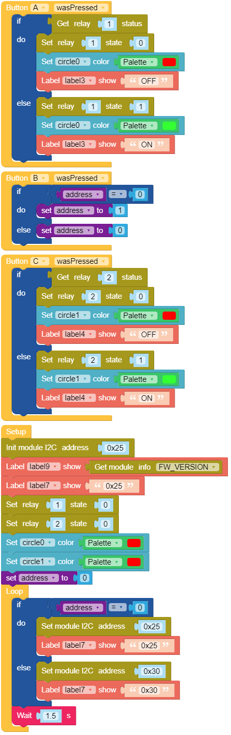

                  • cryptospokC Offline
                    cryptospok @Robertof
                    Hi @Robertof,
                    I reproduced and understood your code, but as you can see in the images, nothing happens.
                    I'm also using UiFlow 1.13.6, it seems that there is some error in the module library...
                    I'm testing with only one 2RELAY module at a time, but both have the same problem.
                    I think the connection is fine... if I put the battery module underneath, the Core2 works without the USC-C connection, that is, with the attached battery (M5GO2 module).
                    Could there be an update in the Core2 firmware?
                    Thank you very much for your help!
