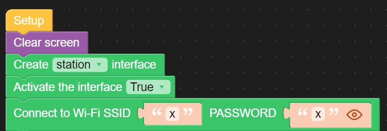

<?xml version="1.0" encoding="UTF-8"?><rss xmlns:dc="http://purl.org/dc/elements/1.1/" xmlns:content="http://purl.org/rss/1.0/modules/content/" xmlns:atom="http://www.w3.org/2005/Atom" version="2.0"><channel><title><![CDATA[UIflow 1.0 Run looks perfect, download everything scrambled]]></title><description><![CDATA[<p dir="auto">I am having a problem when I download using UIFlow, when I run from the program it displays everything correctly in the right location. When I download it copies the location of the buttons, text, lines etc as shown on the UI. As I have lots of menu pages I have written the physical locations of each item and then moved them to the edges of the UI screen. I have to do this as it is so full you cant use the click and drop function when adding new buttons etc. Is there a way to make the UI objects locations be ignored when downloading?</p>

<p dir="auto">The fix for me was enabling wifi at the start of my code, I knew I needed wifi for the RTC functions but assumed it wouldn't affect positioning of objects, but it did. I added a check loop to make sure wifi is connected before proceeding.</p>
<p dir="auto"><img src="/assets/uploads/files/1723874010227-screenshot-2024-08-17-075257.png" alt="Screenshot 2024-08-17 075257.png" class=" img-fluid img-markdown" /></p>
