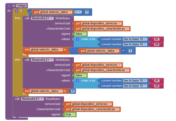

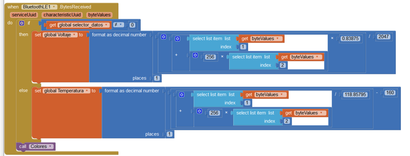

<?xml version="1.0" encoding="UTF-8"?><rss xmlns:dc="http://purl.org/dc/elements/1.1/" xmlns:content="http://purl.org/rss/1.0/modules/content/" xmlns:atom="http://www.w3.org/2005/Atom" version="2.0"><channel><title><![CDATA[Receiving response from BLE server]]></title><description><![CDATA[<p dir="auto">I am trying to receive a bytearray via BLE from a server, but I can't get a response.</p>
<p dir="auto">By sending a certain bytearray via BLE to the <a href="https://sbrick.com/" target="_blank" rel="noopener noreferrer nofollow ugc">Sbrick</a> device, it returns a response indicating the temperature value. And through another bytearray, the voltage value is returned.</p>
<p dir="auto">In App Inventor I get it with these blocks: <img src="/assets/uploads/files/1724780555588-image-1.png" alt="Image 1.png" class=" img-fluid img-markdown" /> <img src="/assets/uploads/files/1724780555601-image-2.png" alt="Image 2.png" class=" img-fluid img-markdown" /></p>

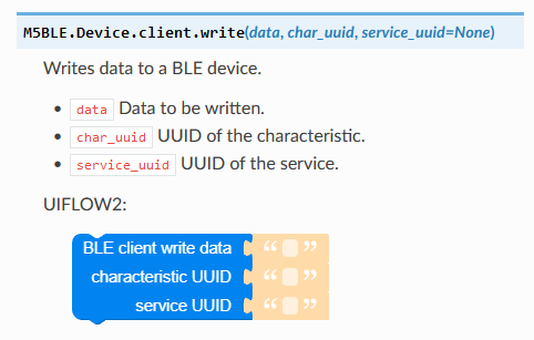

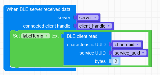

<p dir="auto">But in UiFlow 2.0 I can't get it using these blocks:<br />
<img src="/assets/uploads/files/1724780555609-image-3.png" alt="Image 3.png" class=" img-fluid img-markdown" /> <img src="/assets/uploads/files/1724780555616-image-4.png" alt="Image 4.png" class=" img-fluid img-markdown" /></p>
<p dir="auto">What am I doing wrong?</p>
<p dir="auto">Thank you very much for the help.</p>
