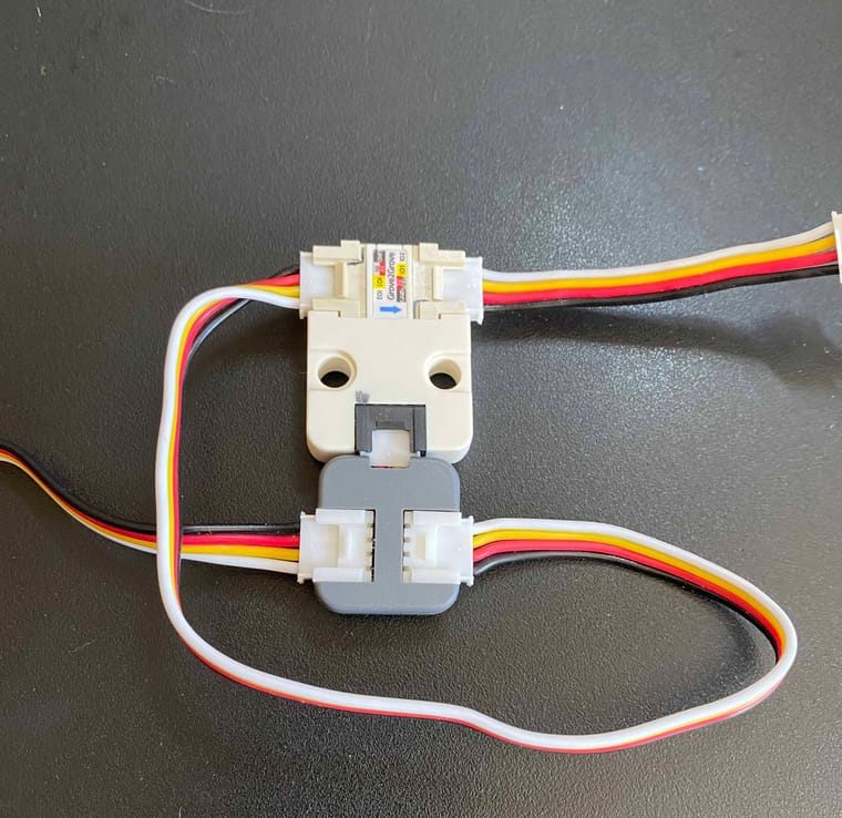

<a href="https://shop.m5stack.com/products/grove-t-connector-5pcs-a-pack" target="_blank" rel="noopener noreferrer nofollow ugc">https://shop.m5stack.com/products/grove-t-connector-5pcs-a-pack</a><br />
I just confirmed that now.<br />
<img src="/assets/uploads/files/1725133230493-img_6165-resized.jpg" alt="IMG_6165.JPG" class=" img-fluid img-markdown" /></p>

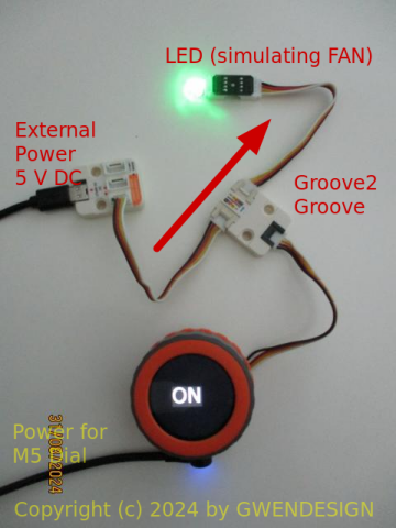

<p dir="auto"><a class="plugin-mentions-user plugin-mentions-a" href="/user/ajb2k3" aria-label="Profile: ajb2k3">@<bdi>ajb2k3</bdi></a> : Groove2Groove 5 V line is <strong>not</strong> connected between the white and black Groove connector by default as R1 isn't populated (at least not in my unit). See schematic <a href="https://docs.m5stack.com/en/unit/unit_grove2grove?id=schematic" target="_blank" rel="noopener noreferrer nofollow ugc">here</a>.</p>
<p dir="auto">@l-roca : the wiring goes as follows:</p>
<pre><code>ext. 5 V        Groove2Groove        FAN
 5 V (red)  ---&gt; 5 V     5 V ---&gt;  (red) 5 V
GND (black) ---&gt; GND     GND ---&gt; (black) GND
                 GND   5 V  D.IN
               (black)(red)(yellow)
                M5Dial  (Port B)
</code></pre>
<p dir="auto"><img src="/assets/uploads/files/1725091834295-m5dial_groove2groove_20240831.png" alt="M5Dial_Groove2Groove_20240831.png" class=" img-fluid img-markdown" /></p>
<p dir="auto">You can find the UIFlow2 example in the Project Zone: <em>M5Dial_Grove2Grove_Test_UIFlow2.1.3</em></p>
<p dir="auto">Thanks<br />
Felix</p>
