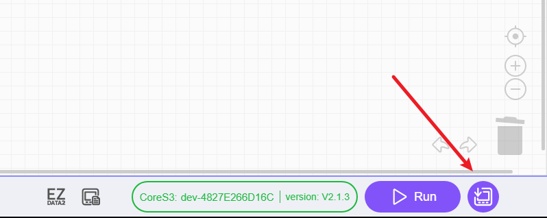

]]></description><link>https://community.m5stack.com/post/26423</link><guid isPermaLink="true">https://community.m5stack.com/post/26423</guid><dc:creator><![CDATA[Coopersmith-24601]]></dc:creator><pubDate>Sat, 14 Sep 2024 05:59:48 GMT</pubDate></item><item><title><![CDATA[Reply to UiFlow 2.1.3 Web app export to .py for use on CoreS3 on Sat, 14 Sep 2024 02:15:31 GMT]]></title><description><![CDATA[<p dir="auto"><a class="plugin-mentions-user plugin-mentions-a" href="/user/coopersmith-24601" aria-label="Profile: Coopersmith-24601">@<bdi>Coopersmith-24601</bdi></a> <img src="/assets/uploads/files/1726280056257-6494632f-2a8a-448f-9599-1ee875b634d8-image.png" alt="6494632f-2a8a-448f-9599-1ee875b634d8-image.png" class=" img-fluid img-markdown" /></p>
<p dir="auto">This will save a copy of the py file to the apps directory. You can then see it in APP.LIST.</p>
]]></description><link>https://community.m5stack.com/post/26421</link><guid isPermaLink="true">https://community.m5stack.com/post/26421</guid><dc:creator><![CDATA[lbuque]]></dc:creator><pubDate>Sat, 14 Sep 2024 02:15:31 GMT</pubDate></item></channel></rss>
