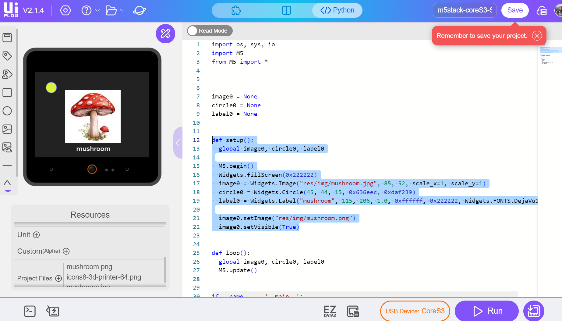

<?xml version="1.0" encoding="UTF-8"?><rss xmlns:dc="http://purl.org/dc/elements/1.1/" xmlns:content="http://purl.org/rss/1.0/modules/content/" xmlns:atom="http://www.w3.org/2005/Atom" version="2.0"><channel><title><![CDATA[Core S3 SE images won&#x27;t show]]></title><description><![CDATA[<p dir="auto">I'm trying to build a really simple program to test the device.  Unfortunately it's failing to even show a simple JPG or PNG image.  What am I missing here?</p>
<pre><code>def setup():
  global image0, circle0, label0
  M5.begin()
  Widgets.fillScreen(0x222222)
  image0 = Widgets.Image("res/img/mushroom.jpg", 85, 52, scale_x=1, scale_y=1)
  circle0 = Widgets.Circle(45, 44, 15, 0x636eec, 0xdaf239)
  label0 = Widgets.Label("mushroom", 115, 206, 1.0, 0xffffff, 0x222222, Widgets.FONTS.DejaVu18)
  image0.setImage("res/img/mushroom.png")
  image0.setVisible(True)
</code></pre>

<p dir="auto">(<img src="/assets/uploads/files/1727316006059-screenshot.png" alt="screenshot.png" class=" img-fluid img-markdown" /> image url)</p>
]]></description><link>https://community.m5stack.com/post/26507</link><guid isPermaLink="true">https://community.m5stack.com/post/26507</guid><dc:creator><![CDATA[greenleaf]]></dc:creator><pubDate>Thu, 26 Sep 2024 02:00:21 GMT</pubDate></item></channel></rss>
