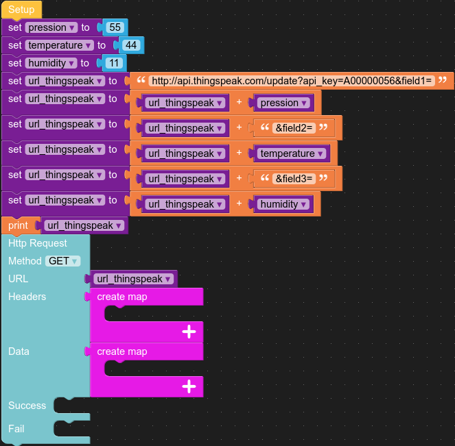

<p dir="auto">try something like below:</p>
<p dir="auto"><img src="/assets/uploads/files/1727626538619-uiflow1createurl_20240929.png" alt="UIFlow1CreateURL_20240929.png" class=" img-fluid img-markdown" /></p>
<p dir="auto">or try using an <code>Execute Code</code> block with this content:</p>
<pre><code>url_thingspeak = 'http://api.thingspeak.com/update?api_key=A00000056&amp;field1=' + str(pression) + '&amp;field2=' + str(temperature) + '&amp;field3=' + str(humidity)
</code></pre>
<p dir="auto">Thanks<br />
Felix</p>
