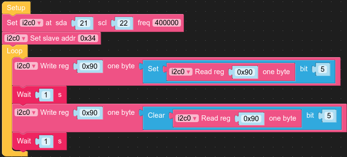

<p dir="auto">if you want to stay with UIFlow<strong>1</strong> you can use the following I2C blocks to turn external 5 V output on and off:</p>
<p dir="auto"><img src="/assets/uploads/files/1727981362466-uiflow1_m5core2v11_extpoweronoff_20240903.png" alt="UIFlow1_M5Core2v11_ExtPowerOnOff_20240903.png" class=" img-fluid img-markdown" /></p>

<p dir="auto">my previous post assumed you are using Arduino (and not UIFlow).</p>
<p dir="auto">That said, I can confirm that in UIFlow<strong>1</strong> setting the power mode doesn't work for M5Core2 v1.1. (I assume it has not been implemented yet.)</p>
<p dir="auto">BTW: It works in UIFlow<strong>2</strong>.</p>
<p dir="auto">Thanks<br />
Felix</p>
