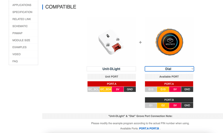

<a href="https://docs.m5stack.com/en/unit/DLight%20Unit" target="_blank" rel="noopener noreferrer nofollow ugc">https://docs.m5stack.com/en/unit/DLight Unit</a><br />
Go down to the FAQ section near the bottom.</p>
<p dir="auto"><img src="/assets/uploads/files/1731451873959-screenshot-2024-11-12-at-5.51.00-pm-resized.png" alt="Screenshot 2024-11-12 at 5.51.00 PM.png" class=" img-fluid img-markdown" /></p>
<p dir="auto">Having said that:<br />
All of the unit sensors will work with any M5Stack controller.<br />
The Dial is just a StampS3 for example.</p>
<p dir="auto">The M5 core bases are another story and require research or asking here if they are compatible.</p>
