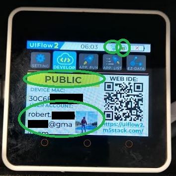

]]></description><link>https://community.m5stack.com/post/26773</link><guid isPermaLink="true">https://community.m5stack.com/post/26773</guid><dc:creator><![CDATA[robski]]></dc:creator><pubDate>Fri, 18 Oct 2024 09:39:54 GMT</pubDate></item><item><title><![CDATA[Reply to M5CoreS3: &quot;ERROR Device type unknown&quot; when trying to connect both CoreS3 and CoreS3 SE to Server. on Fri, 18 Oct 2024 09:34:44 GMT]]></title><description><![CDATA[<p dir="auto"><a class="plugin-mentions-user plugin-mentions-a" href="/user/philb79" aria-label="Profile: PhilB79">@<bdi>PhilB79</bdi></a> so after such process is your device showing connected to uiflow cloud? is it showing your email address (all should be visible on device startup page)<br />
see my core2 example   <img src="/assets/uploads/files/1729244078848-core2_0.jpg" alt="core2_0.JPG" class=" img-fluid img-markdown" /></p>

<p dir="auto">before you give up.</p>
<p dir="auto">For the dot to turn green of any M5Core in the <code>My Device</code> list the M5Core needs to have a wireless connection and an established connection to the UIFlow2 cloud server.</p>
<p dir="auto">On the initial UIFlow2 screen on the M5Core there are two symbols, one for wireless and one for the cloud server, in the top right corner (next to the battery symbol).</p>
