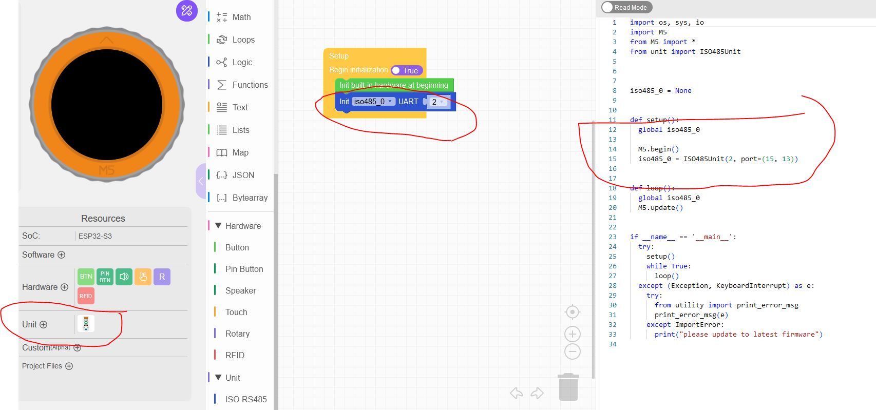

]]></description><link>https://community.m5stack.com/post/26853</link><guid isPermaLink="true">https://community.m5stack.com/post/26853</guid><dc:creator><![CDATA[mukul_100_]]></dc:creator><pubDate>Fri, 25 Oct 2024 12:34:19 GMT</pubDate></item><item><title><![CDATA[Reply to ISO RS485 on M5dial on Thu, 24 Oct 2024 11:49:03 GMT]]></title><description><![CDATA[<p dir="auto"><a class="plugin-mentions-user plugin-mentions-a" href="/user/mukul_100_" aria-label="Profile: mukul_100_">@<bdi>mukul_100_</bdi></a> what software you planning to use?<br />
see uiflow2 init example<br />
<img src="/assets/uploads/files/1729770538550-dial_iso485.jpg" alt="dial_iso485.JPG" class=" img-fluid img-markdown" /></p>
]]></description><link>https://community.m5stack.com/post/26834</link><guid isPermaLink="true">https://community.m5stack.com/post/26834</guid><dc:creator><![CDATA[robski]]></dc:creator><pubDate>Thu, 24 Oct 2024 11:49:03 GMT</pubDate></item></channel></rss>
