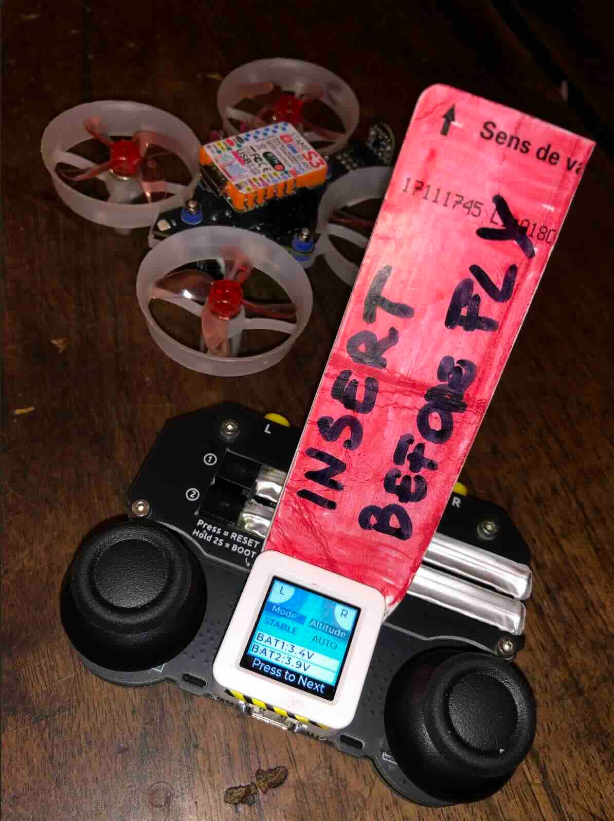

]]></description><link>https://community.m5stack.com/post/27174</link><guid isPermaLink="true">https://community.m5stack.com/post/27174</guid><dc:creator><![CDATA[cepics]]></dc:creator><pubDate>Wed, 27 Nov 2024 17:32:51 GMT</pubDate></item><item><title><![CDATA[Reply to issues with my M5 Atom Fly and Joy on Wed, 27 Nov 2024 15:28:48 GMT]]></title><description><![CDATA[<p dir="auto"><a class="plugin-mentions-user plugin-mentions-a" href="/user/cepics" aria-label="Profile: cepics">@<bdi>cepics</bdi></a> I ended up using the tab off a pop can (paper wasn't thick enough), but it works! I'm now thinking it must be the pins not fully making connection with the Atom. If I twist it just slightly to the right, everything connects again.</p>
<p dir="auto"><img src="/assets/uploads/files/1732721276072-20241127_092515-resized.jpg" alt="20241127_092515.jpg" class=" img-fluid img-markdown" /></p>
<p dir="auto">As for the code, that's on <a href="https://github.com/m5stack/Atom-JoyStick/tree/main/examples/StampFlyController" target="_blank" rel="noopener noreferrer nofollow ugc">GitHub</a>.</p>

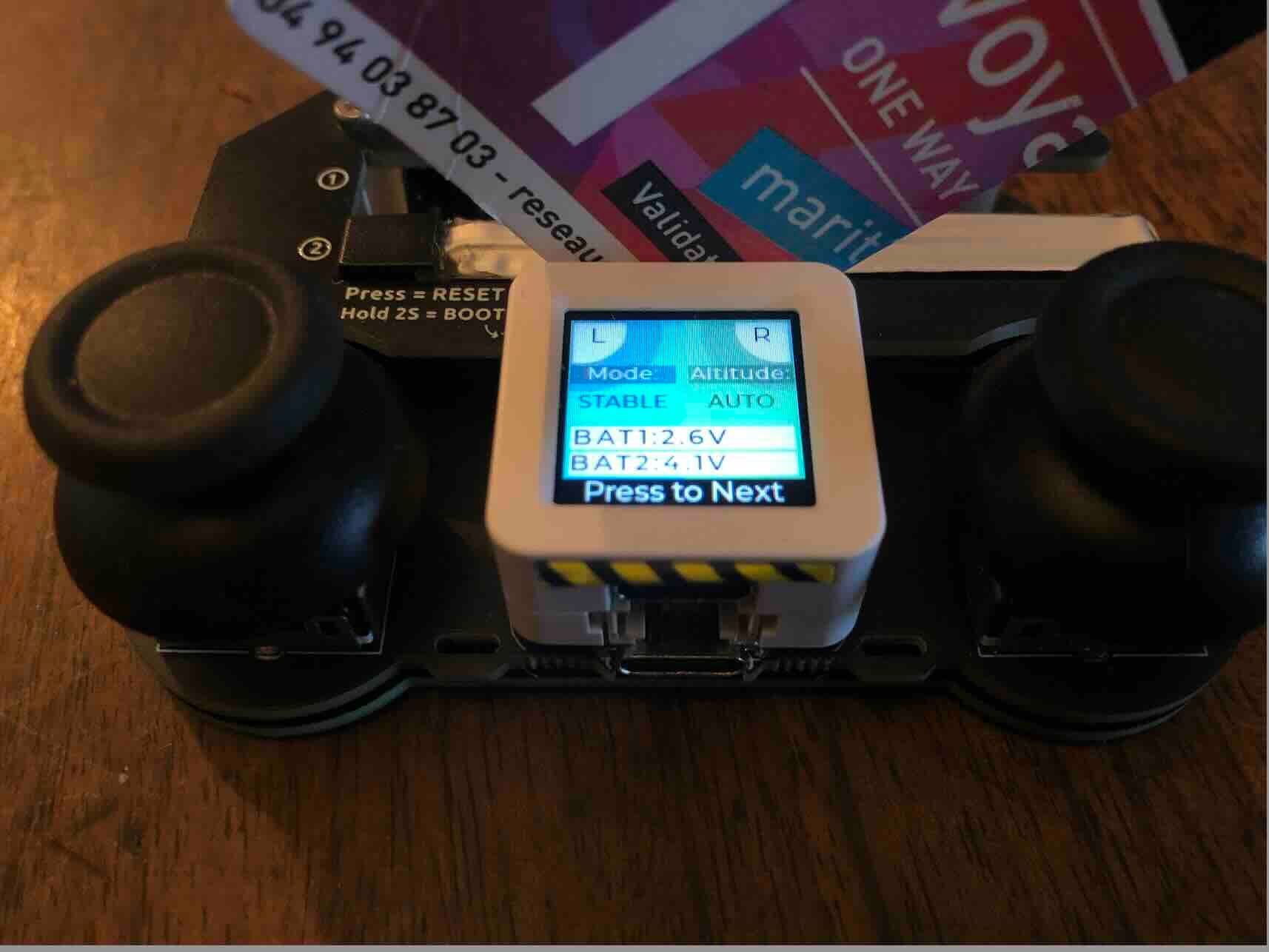

<p dir="auto"><img src="/assets/uploads/files/1732698423953-screenshot-2024-11-27-alle-10.04.14.jpg" alt="Screenshot 2024-11-27 alle 10.04.14.jpg" class=" img-fluid img-markdown" /></p>
