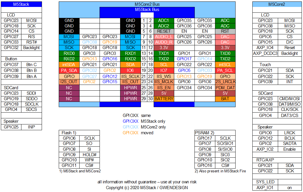

<?xml version="1.0" encoding="UTF-8"?><rss xmlns:dc="http://purl.org/dc/elements/1.1/" xmlns:content="http://purl.org/rss/1.0/modules/content/" xmlns:atom="http://www.w3.org/2005/Atom" version="2.0"><channel><title><![CDATA[M5Stack Core2 Which Pins can I use???]]></title><description><![CDATA[<p dir="auto">I have an M5Stack Core2 AWS and working on designing a project.</p>
<p dir="auto">I haven't been able to find a document that really tells me which pins I can and can not use.</p>
<p dir="auto">I need 3 Comm Ports (probably 2 will use EspSoftwareSerial) and 2 other pins, a Digital Input and a Digital Output.  <strong>I don't see where RXD1/TXD1 (has a UART) pins are available!</strong></p>
<p dir="auto">For the Core2 the pins are listed:<br />
<img src="/assets/uploads/files/1733149901716-m5stackcore2pinout.jpg" alt="M5StackCore2Pinout.jpg" class=" img-fluid img-markdown" /></p>
<p dir="auto">From (hours of) studying,  the ones that I <strong>don't think that I can use</strong> are:</p>
<ol>
<li>intSDA/intSCL (I2C Port, I'll have a 4 relay board that I'll have installed that uses I2C).</li>
<li>RXD0/TXD0 (used for USB Comms)</li>
</ol>
<p dir="auto">Are there other pins that are RESERVED? (besides the obvious: GND, RST, 3.3v, 5v &amp; BAT)</p>
<p dir="auto"><strong>What I THINK I CAN USE:</strong></p>
<ol>
<li>I can use the RXD2/TXD2 for my most important comm port.</li>
<li>G27/G19 as my first SoftwareSerial RX/TX Ports.</li>
<li>G25/G26 as my second SoftwareSerial RX/TX Ports.</li>
<li>G35 &amp; G36 as my Discrete Input and Output pins.<br />
(I have a MAX3232 Serial Interface chip that I can use with 3.3v power.)</li>
</ol>
<p dir="auto">Is this correct?<br />
Are there any  other pins that I could use?</p>
<p dir="auto">Thanks for your help!<br />
Sir Michael</p>

<p dir="auto">I did some more studying, and came up with the following table:</p>
<p dir="auto"><img src="/assets/uploads/files/1733891081546-2d232859-84b4-4421-9143-baaf384d0c65-image.png" alt="2d232859-84b4-4421-9143-baaf384d0c65-image.png" class=" img-fluid img-markdown" /></p>
<p dir="auto">I hope this is right!<br />
Now, I'm not using the M5Stack bottom board which has the PortB and PortC, so I figure that I can use the RXD2/TXD2 pins as well as the G36 and G26 pins. I'll use those for the other 2 SoftwareSerial ports, and G27 and G19 for the other pins.</p>
<p dir="auto">The thing that I found confusing was that they do list the pins in the M5Stack documents, but they don't really explain what is available to the user.  This took a lot more work than it should have!</p>
<p dir="auto">Sir Michael</p>

<img src="/assets/uploads/files/1733192501056-9c8fd8ff-b123-40b8-b941-5b1d7066e6de-image.png" alt="9c8fd8ff-b123-40b8-b941-5b1d7066e6de-image.png" class=" img-fluid img-markdown" /><br />
yes i personally think you're mostly right<br />
and, maybe you can try out PbHub to expand ports?<br />
<a href="https://docs.m5stack.com/en/unit/pbhub_1.1" target="_blank" rel="noopener noreferrer nofollow ugc">https://docs.m5stack.com/en/unit/pbhub_1.1</a></p>
