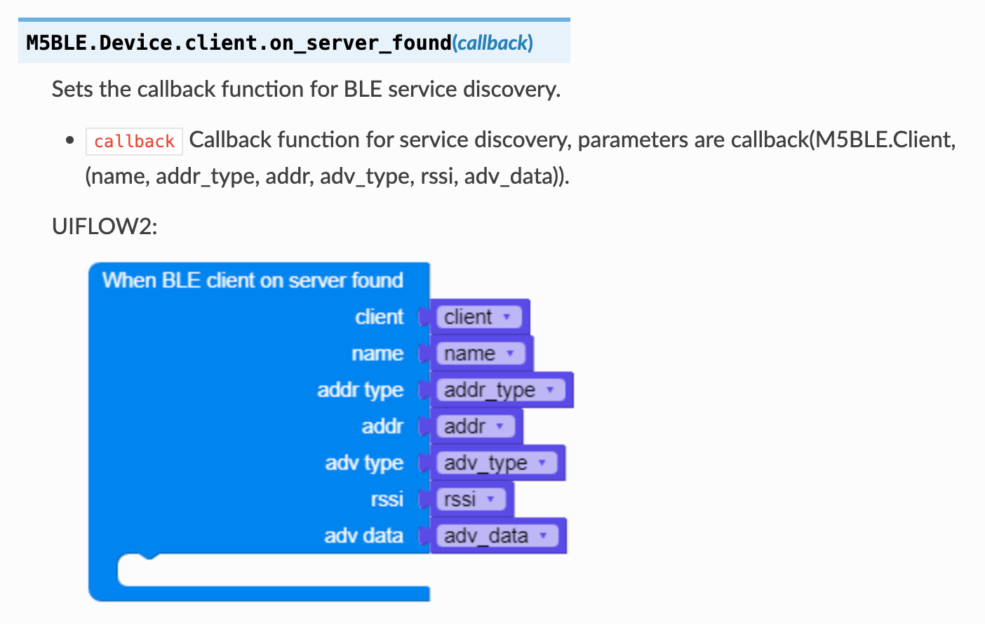

<?xml version="1.0" encoding="UTF-8"?><rss xmlns:dc="http://purl.org/dc/elements/1.1/" xmlns:content="http://purl.org/rss/1.0/modules/content/" xmlns:atom="http://www.w3.org/2005/Atom" version="2.0"><channel><title><![CDATA[How to search for BLE devices in Atom Lite]]></title><description><![CDATA[<p dir="auto">Hi I'm looking for ways to scan BLE devices around Atom Lite and get their MAC address and possibly RSSI and Names.  Is there a way to do this from UIflow or micropython ?</p>

<img src="/assets/uploads/files/1733711407659-eef9351f-6164-427d-9288-4c30ae4a9f1e-image.png" alt="eef9351f-6164-427d-9288-4c30ae4a9f1e-image.png" class=" img-fluid img-markdown" /></p>
<p dir="auto">use M5BLE.Device.client.on_server_found</p>
