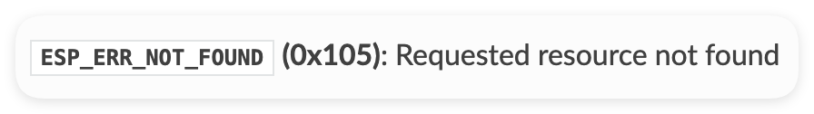

]]></description><link>https://community.m5stack.com/post/27446</link><guid isPermaLink="true">https://community.m5stack.com/post/27446</guid><dc:creator><![CDATA[ajb2k3]]></dc:creator><pubDate>Fri, 13 Dec 2024 06:15:44 GMT</pubDate></item><item><title><![CDATA[Reply to OSError: (-261, &#x27;ESP_ERR_NOT_FOUND&#x27;) on Fri, 13 Dec 2024 02:42:43 GMT]]></title><description><![CDATA[<p dir="auto"><a class="plugin-mentions-user plugin-mentions-a" href="/user/zokizok" aria-label="Profile: ZokiZok">@<bdi>ZokiZok</bdi></a><br />
<img src="/assets/uploads/files/1734057749420-99f884b2-7996-4153-83fd-1381f1f65a8f-qq_1734057744336.png" alt="99f884b2-7996-4153-83fd-1381f1f65a8f-QQ_1734057744336.png" class=" img-fluid img-markdown" /><br />
i think it should be a pin choose problem</p>

I have tested it with 1, 2 and the battery pin 10 always the same error.</p>

I tested it on CoreS3 and this error did not occur. Maybe you chose the wrong pin?</p>
