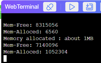

<p dir="auto">Result:<br />
8MB of memory space is now available as shown below.</p>
<p dir="auto"><img src="/assets/uploads/files/1734757204193-%E3%82%B9%E3%82%AF%E3%83%AA%E3%83%BC%E3%83%B3%E3%82%B7%E3%83%A7%E3%83%83%E3%83%88-2024-12-21-135933.png" alt="スクリーンショット 2024-12-21 135933.png" class=" img-fluid img-markdown" /></p>
<p dir="auto">Souce Code Of "Rseult":</p>
<pre><code>import os, sys, io
import M5
from M5 import *
import gc
a = None
def setup():
  global a
  M5.begin()
  print("--start--")
  print("Mem-Free: " + str(gc.mem_free()))
  print("Mem-Alloced: " + str(gc.mem_alloc()))
  a = bytearray(1*1024*1024)
  print("Memory allocated : about 1MB")
def loop():
  global a
  M5.update()
if __name__ == '__main__':
  try:
    setup()
    while True:
      loop()
    try:
      print_error_msg(e)
    except ImportError:
      print("please update to latest firmware")
</code></pre>

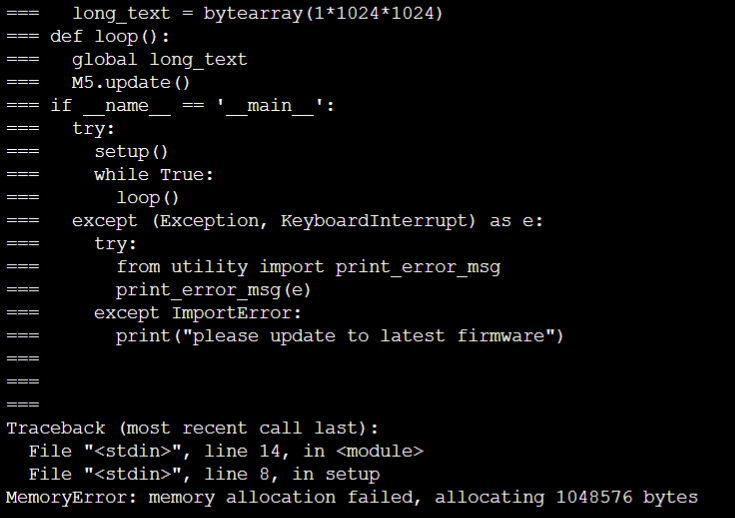

Hello kuriko,<br />
I tried manual memory allocation, but it failed.<br />
Is there any difference from your environment? Did you know anything?</p>
<p dir="auto"><img src="/assets/uploads/files/1734714080663-%E3%82%B9%E3%82%AF%E3%83%AA%E3%83%BC%E3%83%B3%E3%82%B7%E3%83%A7%E3%83%83%E3%83%88-2024-12-21-020014.png" alt="スクリーンショット 2024-12-21 020014.png" class=" img-fluid img-markdown" /></p>
import M5
from M5 import *
long_text = None
def setup():
  global long_text
  M5.begin()
  long_text = bytearray(1*1024*1024)
def loop():
  global long_text
  M5.update()
  try:
    setup()
    while True:
      loop()
    try:
      print_error_msg(e)
    except ImportError:
</code></pre>
