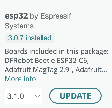

<img src="/assets/uploads/files/1734658153820-323085e3-ebb8-47e9-b569-a31c40a0f2f9-image.png" alt="323085e3-ebb8-47e9-b569-a31c40a0f2f9-image.png" class=" img-fluid img-markdown" /><br />
Just switch the esp32 library version in the boards manager to below 3.1.0.</p>
