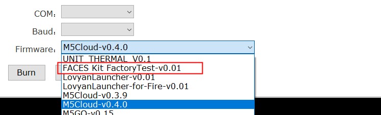

]]></description><link>https://community.m5stack.com/post/5118</link><guid isPermaLink="true">https://community.m5stack.com/post/5118</guid><dc:creator><![CDATA[sysdl132]]></dc:creator><pubDate>Tue, 13 Aug 2019 13:50:22 GMT</pubDate></item><item><title><![CDATA[Reply to M5Stack Grey module ... OSError: [Errno 2] ENOENT on Tue, 19 Mar 2019 05:45:01 GMT]]></title><description><![CDATA[<p dir="auto"><a class="plugin-mentions-user plugin-mentions-a" href="/user/pbdevastator" aria-label="Profile: pbdevastator">@<bdi>pbdevastator</bdi></a> <img src="/assets/uploads/files/1552974230590-repl.jpg" alt="0_1552974229447_repl.JPG" class=" img-fluid img-markdown" /></p>
<p dir="auto">Try the lastest M5Burner</p>
<p dir="auto">the factorytest firmware is REPL mode</p>
