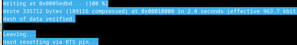

<p dir="auto">Upload occurs:<br />
<img src="/assets/uploads/files/1735249458757-019fe53a-8f75-4c99-99a5-ffb291d2ddfe-image.png" alt="019fe53a-8f75-4c99-99a5-ffb291d2ddfe-image.png" class=" img-fluid img-markdown" /></p>
<p dir="auto">After which the device doesn't turn on and clear the screen on reboot.</p>
