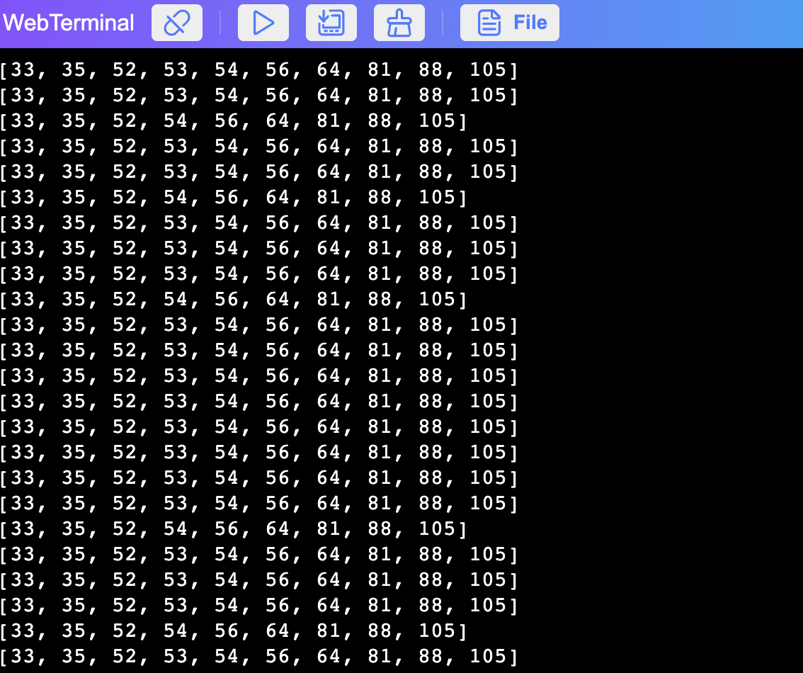

<p dir="auto">Thanks for trying.</p>
<p dir="auto">It's working now... and I feel so dumb 🤦‍♂️<br />
I just realized that the one thing I didn't checked was the Power Supply..., it looks like my Power Supply did not deliver an high enough voltage for the PPS-Module to be stable... although it should have according to the specs.</p>
<p dir="auto">Do you guys know of a way to "revive" or "re-flash" the 2 broken PPS-Modules that I've tried to update to the latest firmware ?</p>

<p dir="auto">Hi all,</p>
<p dir="auto">I ordered a couple of Module13.2 PPS (SKU:M137) modules for use with the M5Stack CoreS3 main units.<br />
Unfortunately I can't get it to work, when I upload a "Default" test code (Initialize the unit, set output to True and after that Set the current and voltage to desired levels) sometimes it works just one time, but most of the time the module does not respond, or it says: Module not found.</p>
<p dir="auto">I also tried scanning for I2C devices and I found out that the address is not present all the time, it fluctuates between present and not present, this does not happen with other I2C devices on the same bus, I of course use the standard address: 0x35 and i have a stable 24V on the DC-in connector (1A capable) and no load attached to the output.</p>

<p dir="auto">( All of the above is tried using UIFlow 2 by the way.<br />
I also tried it using custom commands via the I2C module in UIFlow but I get the exact same results (sometimes it works but most of the time the PPS-module does not respond to commands)</p>
<p dir="auto">This is the result of scanning I2C devices with the PPS-Module attached:<br />
<img src="/assets/uploads/files/1735840567990-uiflow2.0-i2cscan.png" alt="UIFlow2.0-I2Cscan.png" class=" img-fluid img-markdown" /></p>
<p dir="auto">It's all about the "53" which is 0x35 in HEX (The address of the PPS-module)<br />
You see that it's not constantly available and this is why the communication often doesn't work...</p>
