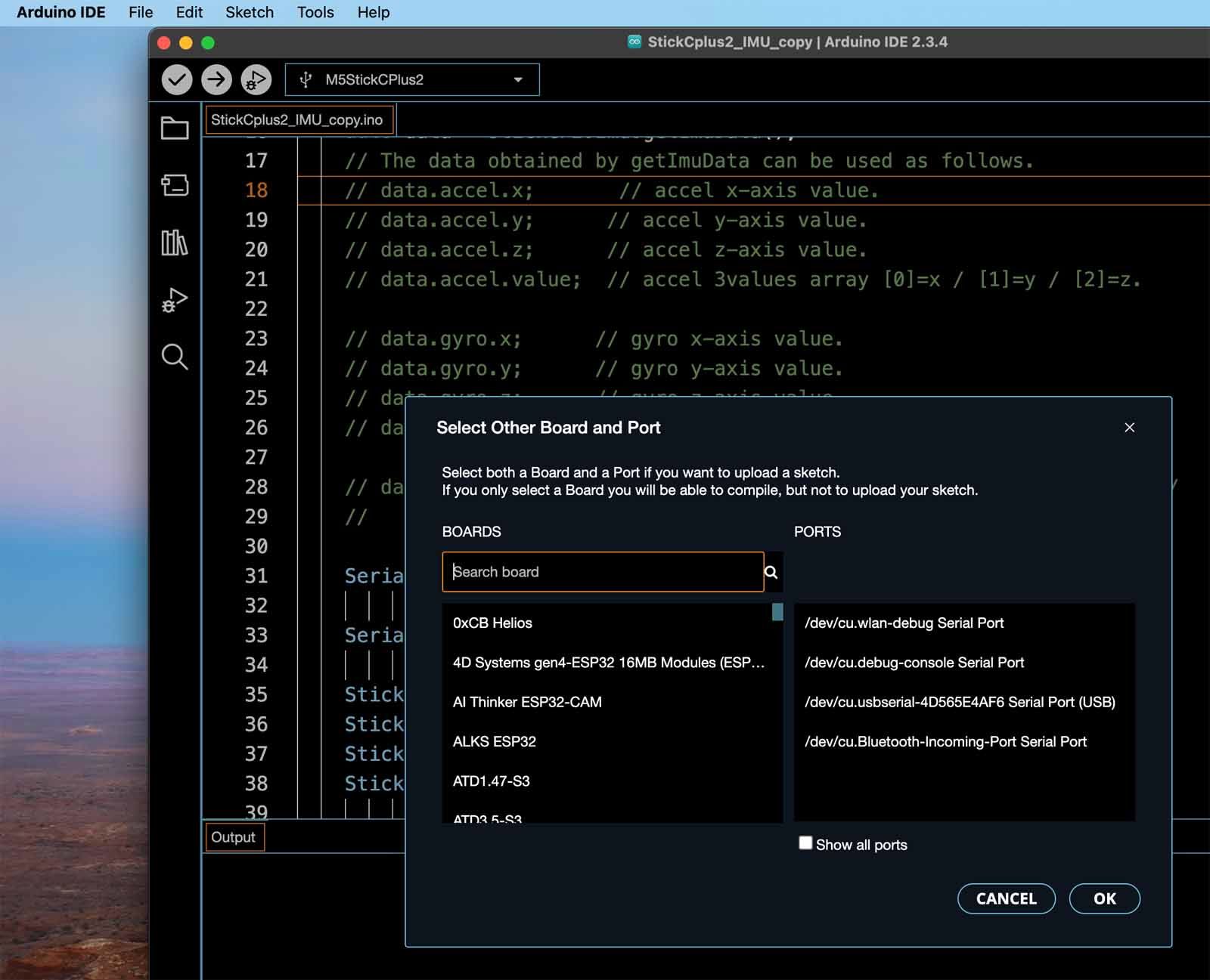

]]></description><link>https://community.m5stack.com/topic/7279/m5stack-reflective-ir-sensor-always-reads-0</link><generator>RSS for Node</generator><lastBuildDate>Sat, 09 May 2026 14:51:35 GMT</lastBuildDate><atom:link href="https://community.m5stack.com/topic/7279.rss" rel="self" type="application/rss+xml"/><pubDate>Sun, 09 Feb 2025 14:56:47 GMT</pubDate><ttl>60</ttl><item><title><![CDATA[Reply to M5Stack Reflective IR Sensor Always Reads 0 on Wed, 12 Feb 2025 15:34:29 GMT]]></title><description><![CDATA[<p dir="auto"><a class="plugin-mentions-user plugin-mentions-a" href="/user/shinshin8" aria-label="Profile: shinshin8">@<bdi>shinshin8</bdi></a> You must ignore that the Arduino IDE reports lilygo boards and select your own Core from the drop down. The IDE is just trying to be helpful, but is always wrong, just ignore it and select the correct board from the drop down list in the little window here:<img src="/assets/uploads/files/1739373850129-1600.jpg" alt="1600.jpg" class=" img-fluid img-markdown" /></p>
<p dir="auto">Also questions:<br />
Are you using this example:<br />
<a href="https://github.com/m5stack/M5Unit-ReflectiveIR/blob/main/examples/detect.ino" target="_blank" rel="noopener noreferrer nofollow ugc">https://github.com/m5stack/M5Unit-ReflectiveIR/blob/main/examples/detect.ino</a>?</p>
<p dir="auto">Have you tried adjusting the sensitivity trim pot full scale, CW, CCW?</p>
<p dir="auto">Your hand may not reflect enough IR.</p>
<p dir="auto">The output is active low, so you should see 0Vdc when a reflective object is in the path. ADC will output 0 digital, Off as well.</p>
