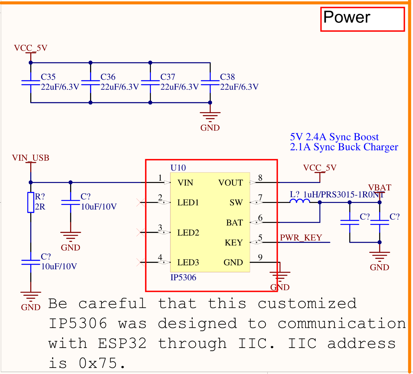

The bottom plate (with all the GPIO pins) contains the battery.<br />
The back should have a switch marked 1/0.<br />
The switch must be set to 1 and the device powered on by USB.<br />
The device must be ON during this time, I think, for the battery to charge.<br />
Until you feel it is charged, then unplug the USB and see if the charge is maintained.<br />
It only charges this way.</p>
<p dir="auto"><img src="/assets/uploads/files/1741561125937-screenshot-2025-03-09-at-6.58.33-pm.png" alt="Screenshot 2025-03-09 at 6.58.33 PM.png" class=" img-fluid img-markdown" /></p>

<p dir="auto">there is a <code>POWER SWITCH</code> at the bottom. See <a href="https://docs.m5stack.com/en/core/basic_v2.7" target="_blank" rel="noopener noreferrer nofollow ugc">here</a>. Make sure it is in the <code>on</code> position to charge and/or power M5Core.</p>
<p dir="auto">Thanks<br />
