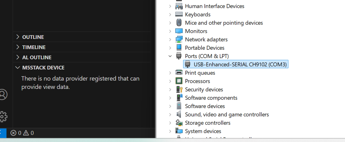

]]></description><link>https://community.m5stack.com/topic/7448/core-basic-v2-7-not-shown-in-ide</link><generator>RSS for Node</generator><lastBuildDate>Wed, 29 Apr 2026 01:47:39 GMT</lastBuildDate><atom:link href="https://community.m5stack.com/topic/7448.rss" rel="self" type="application/rss+xml"/><pubDate>Thu, 27 Mar 2025 17:54:56 GMT</pubDate><ttl>60</ttl><item><title><![CDATA[Reply to Core Basic v2.7 not shown in IDE on Fri, 11 Apr 2025 18:12:22 GMT]]></title><description><![CDATA[<p dir="auto"><a class="plugin-mentions-user plugin-mentions-a" href="/user/pleister" aria-label="Profile: pleister">@<bdi>pleister</bdi></a> found the solution in rebuilding the extension <a href="https://github.com/curdeveryday/vscode-m5stack-mpy/issues/45" target="_blank" rel="noopener noreferrer nofollow ugc">https://github.com/curdeveryday/vscode-m5stack-mpy/issues/45</a></p>

<img src="/assets/uploads/files/1743611483076-a2cae0c1-d731-4423-9758-af3088b68478-image.png" alt="a2cae0c1-d731-4423-9758-af3088b68478-image.png" class=" img-fluid img-markdown" /></p>

]]></description><link>https://community.m5stack.com/post/28757</link><guid isPermaLink="true">https://community.m5stack.com/post/28757</guid><dc:creator><![CDATA[robski]]></dc:creator><pubDate>Wed, 02 Apr 2025 09:04:28 GMT</pubDate></item><item><title><![CDATA[Reply to Core Basic v2.7 not shown in IDE on Wed, 02 Apr 2025 09:00:43 GMT]]></title><description><![CDATA[<p dir="auto"><a class="plugin-mentions-user plugin-mentions-a" href="/user/robski" aria-label="Profile: robski">@<bdi>robski</bdi></a> yes Burner is dedecting it and I can burn the software on it. This is why I don't understand the problem.</p>
]]></description><link>https://community.m5stack.com/post/28756</link><guid isPermaLink="true">https://community.m5stack.com/post/28756</guid><dc:creator><![CDATA[pleister]]></dc:creator><pubDate>Wed, 02 Apr 2025 09:00:43 GMT</pubDate></item><item><title><![CDATA[Reply to Core Basic v2.7 not shown in IDE on Fri, 28 Mar 2025 07:31:37 GMT]]></title><description><![CDATA[<p dir="auto">is it detected by M5Burner or/and Arduino?</p>
