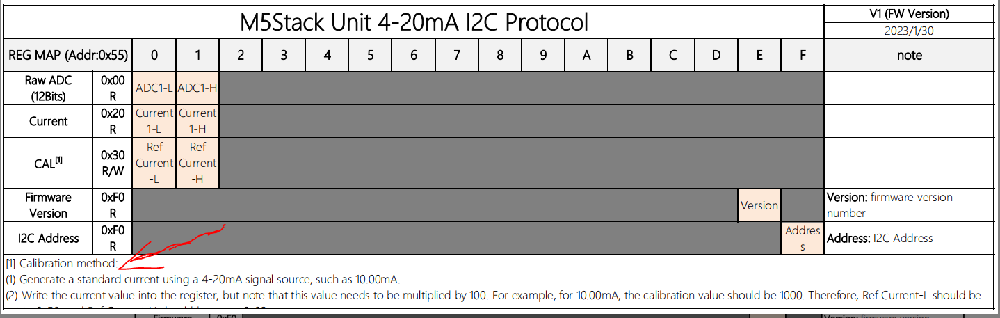

<p dir="auto">so you mean if I measure with multimter 4.0 mA (which is true for the sensor) and the unit shows me 7.2 mA I should set the calibrated value to 4.0 ?</p>
<p dir="auto">Because this is not mentioned anywhere in a readme file or manual or in the description of the device, and it is not made in the example file at github<br />
but I am a beginner....</p>
]]></description><link>https://community.m5stack.com/post/28740</link><guid isPermaLink="true">https://community.m5stack.com/post/28740</guid><dc:creator><![CDATA[obstbauer]]></dc:creator><pubDate>Tue, 01 Apr 2025 12:11:00 GMT</pubDate></item><item><title><![CDATA[Reply to 4-20 mA Unit with wemos S2 mini ESP32 on Tue, 01 Apr 2025 10:51:44 GMT]]></title><description><![CDATA[<p dir="auto"><a class="plugin-mentions-user plugin-mentions-a" href="/user/obstbauer" aria-label="Profile: obstbauer">@<bdi>obstbauer</bdi></a> try calibration function based on what you see with multimeter</p>

I have a current reading but the value is wrong,<br />
I get soemthing around 7.2 mA instead of 4 mA.<br />
I can measure the 4 mA with a multimeter in the circuit and the sensor should send 4 mA, so this is ok, but the M5Stack unit shows 7.2 mA and I don't understand why ? Any ideas ?<br />
My sensor is passive, I connected 24 V to the 4-20mA unit and all three jumpers are installed<br />
What is the meaning of the function "getCalCurrent" ? It is neessary for the current measurement ? It is necessary to set a "ref current" ?</p>
