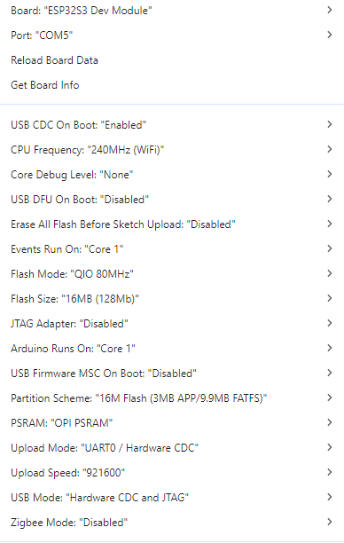

<p dir="auto">This too:<br />
<img src="/assets/uploads/files/1744132323790-image.png" alt="image.png" class=" img-fluid img-markdown" /></p>
<p dir="auto">You can see the picture says ESP32S3 Dev Module.  I also tried using M5Stack M5PaperS3 as the board.  Tried multiple USB Ports.  It communicates, I said that...  I am just stuck.  Please help if you can.  Thank you all!</p>

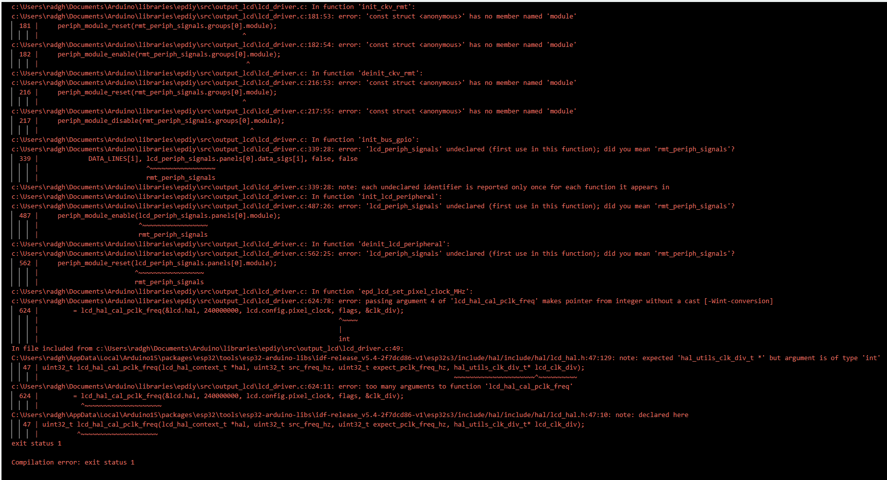

<p dir="auto">Code remained the same.  EPDiy updated to 2.0.0.</p>
<p dir="auto">Error code:</p>
<pre><code>c:\Users\radgh\Documents\Arduino\libraries\epdiy\src\output_lcd\lcd_driver.c: In function 'epd_lcd_set_pixel_clock_MHz':
c:\Users\radgh\Documents\Arduino\libraries\epdiy\src\output_lcd\lcd_driver.c:614:78: error: passing argument 4 of 'lcd_hal_cal_pclk_freq' makes pointer from integer without a cast [-Wint-conversion]
  614 |         = lcd_hal_cal_pclk_freq(&amp;lcd.hal, 240000000, lcd.config.pixel_clock, flags, &amp;clk_div);
      |                                                                              int
In file included from c:\Users\radgh\Documents\Arduino\libraries\epdiy\src\output_lcd\lcd_driver.c:41:
C:\Users\radgh\AppData\Local\Arduino15\packages\esp32\tools\esp32-arduino-libs\idf-release_v5.4-2f7dcd86-v1\esp32s3/include/hal/include/hal/lcd_hal.h:47:129: note: expected 'hal_utils_clk_div_t *' but argument is of type 'int'
   47 | uint32_t lcd_hal_cal_pclk_freq(lcd_hal_context_t *hal, uint32_t src_freq_hz, uint32_t expect_pclk_freq_hz, hal_utils_clk_div_t* lcd_clk_div);
c:\Users\radgh\Documents\Arduino\libraries\epdiy\src\output_lcd\lcd_driver.c:614:11: error: too many arguments to function 'lcd_hal_cal_pclk_freq'
C:\Users\radgh\AppData\Local\Arduino15\packages\esp32\tools\esp32-arduino-libs\idf-release_v5.4-2f7dcd86-v1\esp32s3/include/hal/include/hal/lcd_hal.h:47:10: note: declared here
exit status 1
Compilation error: exit status 1
</code></pre>

<p dir="auto">Here are my error messages:</p>
<pre><code>c:\Users\radgh\Documents\Arduino\libraries\epdiy\src\output_lcd\lcd_driver.c: In function 'init_ckv_rmt':
c:\Users\radgh\Documents\Arduino\libraries\epdiy\src\output_lcd\lcd_driver.c:181:53: error: 'const struct &lt;anonymous&gt;' has no member named 'module'
  181 |     periph_module_reset(rmt_periph_signals.groups[0].module);
c:\Users\radgh\Documents\Arduino\libraries\epdiy\src\output_lcd\lcd_driver.c:182:54: error: 'const struct &lt;anonymous&gt;' has no member named 'module'
  182 |     periph_module_enable(rmt_periph_signals.groups[0].module);
c:\Users\radgh\Documents\Arduino\libraries\epdiy\src\output_lcd\lcd_driver.c: In function 'deinit_ckv_rmt':
c:\Users\radgh\Documents\Arduino\libraries\epdiy\src\output_lcd\lcd_driver.c:216:53: error: 'const struct &lt;anonymous&gt;' has no member named 'module'
  216 |     periph_module_reset(rmt_periph_signals.groups[0].module);
c:\Users\radgh\Documents\Arduino\libraries\epdiy\src\output_lcd\lcd_driver.c:217:55: error: 'const struct &lt;anonymous&gt;' has no member named 'module'
  217 |     periph_module_disable(rmt_periph_signals.groups[0].module);
c:\Users\radgh\Documents\Arduino\libraries\epdiy\src\output_lcd\lcd_driver.c: In function 'init_bus_gpio':
c:\Users\radgh\Documents\Arduino\libraries\epdiy\src\output_lcd\lcd_driver.c:339:28: error: 'lcd_periph_signals' undeclared (first use in this function); did you mean 'rmt_periph_signals'?
  339 |             DATA_LINES[i], lcd_periph_signals.panels[0].data_sigs[i], false, false
      |                            rmt_periph_signals
c:\Users\radgh\Documents\Arduino\libraries\epdiy\src\output_lcd\lcd_driver.c:339:28: note: each undeclared identifier is reported only once for each function it appears in
c:\Users\radgh\Documents\Arduino\libraries\epdiy\src\output_lcd\lcd_driver.c: In function 'init_lcd_peripheral':
c:\Users\radgh\Documents\Arduino\libraries\epdiy\src\output_lcd\lcd_driver.c:487:26: error: 'lcd_periph_signals' undeclared (first use in this function); did you mean 'rmt_periph_signals'?
  487 |     periph_module_enable(lcd_periph_signals.panels[0].module);
      |                          rmt_periph_signals
c:\Users\radgh\Documents\Arduino\libraries\epdiy\src\output_lcd\lcd_driver.c: In function 'deinit_lcd_peripheral':
c:\Users\radgh\Documents\Arduino\libraries\epdiy\src\output_lcd\lcd_driver.c:562:25: error: 'lcd_periph_signals' undeclared (first use in this function); did you mean 'rmt_periph_signals'?
  562 |     periph_module_reset(lcd_periph_signals.panels[0].module);
      |                         rmt_periph_signals
c:\Users\radgh\Documents\Arduino\libraries\epdiy\src\output_lcd\lcd_driver.c:624:78: error: passing argument 4 of 'lcd_hal_cal_pclk_freq' makes pointer from integer without a cast [-Wint-conversion]
  624 |         = lcd_hal_cal_pclk_freq(&amp;lcd.hal, 240000000, lcd.config.pixel_clock, flags, &amp;clk_div);
      |                                                                              int
In file included from c:\Users\radgh\Documents\Arduino\libraries\epdiy\src\output_lcd\lcd_driver.c:49:
c:\Users\radgh\Documents\Arduino\libraries\epdiy\src\output_lcd\lcd_driver.c:624:11: error: too many arguments to function 'lcd_hal_cal_pclk_freq'
exit status 1
</code></pre>

<p dir="auto">c:\Users\radgh\Documents\Arduino\libraries\epdiy\src\output_lcd\lcd_driver.c: In function 'init_ckv_rmt':<br />
c:\Users\radgh\Documents\Arduino\libraries\epdiy\src\output_lcd\lcd_driver.c:181:53: error: 'const struct &lt;anonymous&gt;' has no member named 'module'<br />
181 |     periph_module_reset(rmt_periph_signals.groups[0].module);<br />
|                                                     ^<br />
c:\Users\radgh\Documents\Arduino\libraries\epdiy\src\output_lcd\lcd_driver.c:182:54: error: 'const struct &lt;anonymous&gt;' has no member named 'module'<br />
182 |     periph_module_enable(rmt_periph_signals.groups[0].module);<br />
|                                                      ^<br />
c:\Users\radgh\Documents\Arduino\libraries\epdiy\src\output_lcd\lcd_driver.c: In function 'deinit_ckv_rmt':<br />
c:\Users\radgh\Documents\Arduino\libraries\epdiy\src\output_lcd\lcd_driver.c:216:53: error: 'const struct &lt;anonymous&gt;' has no member named 'module'<br />
216 |     periph_module_reset(rmt_periph_signals.groups[0].module);<br />
|                                                     ^<br />
c:\Users\radgh\Documents\Arduino\libraries\epdiy\src\output_lcd\lcd_driver.c:217:55: error: 'const struct &lt;anonymous&gt;' has no member named 'module'<br />
217 |     periph_module_disable(rmt_periph_signals.groups[0].module);<br />
|                                                       ^<br />
c:\Users\radgh\Documents\Arduino\libraries\epdiy\src\output_lcd\lcd_driver.c: In function 'init_bus_gpio':<br />
c:\Users\radgh\Documents\Arduino\libraries\epdiy\src\output_lcd\lcd_driver.c:339:28: error: 'lcd_periph_signals' undeclared (first use in this function); did you mean 'rmt_periph_signals'?<br />
339 |             DATA_LINES[i], lcd_periph_signals.panels[0].data_sigs[i], false, false<br />
|                            ^~~~~~~~~~~~~~~~~~<br />
|                            rmt_periph_signals<br />
c:\Users\radgh\Documents\Arduino\libraries\epdiy\src\output_lcd\lcd_driver.c:339:28: note: each undeclared identifier is reported only once for each function it appears in<br />
c:\Users\radgh\Documents\Arduino\libraries\epdiy\src\output_lcd\lcd_driver.c: In function 'init_lcd_peripheral':<br />
c:\Users\radgh\Documents\Arduino\libraries\epdiy\src\output_lcd\lcd_driver.c:487:26: error: 'lcd_periph_signals' undeclared (first use in this function); did you mean 'rmt_periph_signals'?<br />
487 |     periph_module_enable(lcd_periph_signals.panels[0].module);<br />
c:\Users\radgh\Documents\Arduino\libraries\epdiy\src\output_lcd\lcd_driver.c: In function 'deinit_lcd_peripheral':<br />
c:\Users\radgh\Documents\Arduino\libraries\epdiy\src\output_lcd\lcd_driver.c:562:25: error: 'lcd_periph_signals' undeclared (first use in this function); did you mean 'rmt_periph_signals'?<br />
562 |     periph_module_reset(lcd_periph_signals.panels[0].module);<br />
c:\Users\radgh\Documents\Arduino\libraries\epdiy\src\output_lcd\lcd_driver.c: In function 'epd_lcd_set_pixel_clock_MHz':<br />
c:\Users\radgh\Documents\Arduino\libraries\epdiy\src\output_lcd\lcd_driver.c:624:78: error: passing argument 4 of 'lcd_hal_cal_pclk_freq' makes pointer from integer without a cast [-Wint-conversion]<br />
624 |         = lcd_hal_cal_pclk_freq(&amp;lcd.hal, 240000000, lcd.config.pixel_clock, flags, &amp;clk_div);<br />
|                                                                              ^~~~~<br />
|                                                                              |<br />
|                                                                              int<br />
In file included from c:\Users\radgh\Documents\Arduino\libraries\epdiy\src\output_lcd\lcd_driver.c:49:<br />
C:\Users\radgh\AppData\Local\Arduino15\packages\esp32\tools\esp32-arduino-libs\idf-release_v5.4-2f7dcd86-v1\esp32s3/include/hal/include/hal/lcd_hal.h:47:129: note: expected 'hal_utils_clk_div_t *' but argument is of type 'int'<br />
47 | uint32_t lcd_hal_cal_pclk_freq(lcd_hal_context_t <em>hal, uint32_t src_freq_hz, uint32_t expect_pclk_freq_hz, hal_utils_clk_div_t</em> lcd_clk_div);<br />
|                                                                                                            ~<s><s><s><s><s><s><s><s><s><s>^</s></s></s></s></s><br />
c:\Users\radgh\Documents\Arduino\libraries\epdiy\src\output_lcd\lcd_driver.c:624:11: error: too many arguments to function 'lcd_hal_cal_pclk_freq'<br />
|           ^</s></s></s></s></s>~~~~~~~~~~<br />
C:\Users\radgh\AppData\Local\Arduino15\packages\esp32\tools\esp32-arduino-libs\idf-release_v5.4-2f7dcd86-v1\esp32s3/include/hal/include/hal/lcd_hal.h:47:10: note: declared here<br />
|          ^~~~~~~~~~~~~~~~~~~~~<br />
exit status 1</p>
<p dir="auto">Compilation error: exit status 1</p>
<p dir="auto">In my novice mind, this looks like undeclared variables... in the epdiy library?  I performed a 'git bash' on the epdiy library to get the right version.  the "git reset" command from the setup instructions.  Going to check out the rest of your suggestions now.</p>
<p dir="auto">Picture just in case this helps.<br />
<img src="/assets/uploads/files/1744163888040-3fa21e7f-526e-4838-881c-4a7b69888148-image.png" alt="3fa21e7f-526e-4838-881c-4a7b69888148-image.png" class=" img-fluid img-markdown" /></p>
]]></description><link>https://community.m5stack.com/post/28838</link><guid isPermaLink="true">https://community.m5stack.com/post/28838</guid><dc:creator><![CDATA[RadghKris]]></dc:creator><pubDate>Wed, 09 Apr 2025 02:03:55 GMT</pubDate></item><item><title><![CDATA[Reply to NEED HELP: No screen, PaperS3 beeps and returns Serial monitor communication.... on Tue, 08 Apr 2025 20:25:09 GMT]]></title><description><![CDATA[<p dir="auto"><a class="plugin-mentions-user plugin-mentions-a" href="/user/felmue" aria-label="Profile: felmue">@<bdi>felmue</bdi></a> Thank you for your reply!  I will check this when I get back to my workstation tonight.  I will keep you posted!</p>
