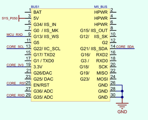

]]></description><link>https://community.m5stack.com/post/28902</link><guid isPermaLink="true">https://community.m5stack.com/post/28902</guid><dc:creator><![CDATA[nathannnn]]></dc:creator><pubDate>Wed, 16 Apr 2025 06:16:03 GMT</pubDate></item><item><title><![CDATA[Reply to M5Stack GRBL 13.2 Module serial connection on Tue, 15 Apr 2025 07:19:07 GMT]]></title><description><![CDATA[<p dir="auto"><a class="plugin-mentions-user plugin-mentions-a" href="/user/nathannnn" aria-label="Profile: nathannnn">@<bdi>nathannnn</bdi></a>  are you sure you can talk to it via uart pins as it looks like they are not connected between mbus and  atmega, isn't it I2C path you need to use?</p>
<p dir="auto"><img src="/assets/uploads/files/1744701535354-mbusgrbl.png" alt="mbusgrbl.PNG" class=" img-fluid img-markdown" /></p>
