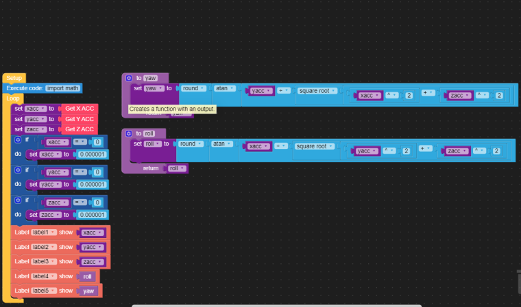

<p dir="auto">Managed to get some more accurate x and ydegrees.<br />
Is it possible to get yaw heading with uiflow?</p>
