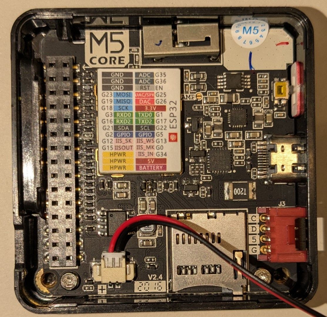

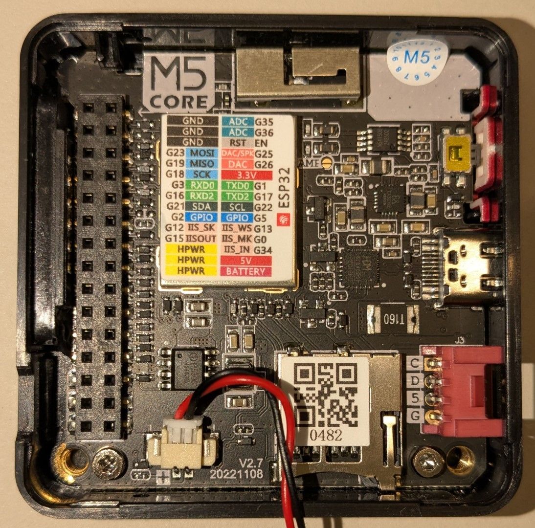

<?xml version="1.0" encoding="UTF-8"?><rss xmlns:dc="http://purl.org/dc/elements/1.1/" xmlns:content="http://purl.org/rss/1.0/modules/content/" xmlns:atom="http://www.w3.org/2005/Atom" version="2.0"><channel><title><![CDATA[Battery charging does not work on BASIC V2.7]]></title><description><![CDATA[<p dir="auto">BASIC V2.7 does not charge with approx. 500mA.<br />
Not with the original battery, which is plugged into the back and also not at the connector directly on the PCB.<br />
With the BASIC V2.4 it charges fine with 500mA. I have also tested 800mA via the FW.</p>
<p dir="auto">I tested the factory image and also my own FW. It works on one, but not on the other.</p>
<p dir="auto">In addition, the V2.4 does not work with the bottom battery (with switch) of the V2.7.</p>
<p dir="auto">All very strange.<br />
I need help :|</p>
<p dir="auto"><img src="%5B%5Berror:parse-error%5D%5D" alt="BASIC_v24_resizeL.jpg" class=" img-fluid img-markdown" /> <img src="%5B%5Berror:parse-error%5D%5D" alt="BASIC_v27_resizeL.jpg" class=" img-fluid img-markdown" /></p>

<p dir="auto">I measured the voltage of the ‘5V pin’.<br />
With the V2.4 I get 5 V,<br />
<strong>with the V2.7 only 4.7V.</strong></p>
<p dir="auto">Could this be the reason why it only charges with a maximum <strong>of 150 to 200mA?</strong></p>
<p dir="auto">How can I <strong>increase</strong> the voltage output of the <strong>IP5306</strong>?</p>
<p dir="auto">Is this possible via i2c?</p>

<img src="/assets/uploads/files/1749030909900-basic_v24_resizel.jpg" alt="BASIC_v24_resizeL.jpg" class=" img-fluid img-markdown" /><br />
<img src="/assets/uploads/files/1749030929711-basic_v27_resizel.jpg" alt="BASIC_v27_resizeL.jpg" class=" img-fluid img-markdown" /></p>
