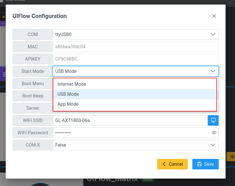

<p dir="auto">thank you for this information. I just retried M5StampPico with UIFlow<strong>1</strong> and changed the <em>Start Mode</em> to <em>USB Mode</em> and back to <em>Internet Mode</em>. In both cases I get the blue light. So I guess it's not connected to the server.</p>
<p dir="auto">Thanks<br />
Felix</p>

The blue LED indicates that it is currently working in USB mode or is not connected to the server<br />
<img src="/assets/uploads/files/1749692938067-a1f7beb1-87da-470d-9d2d-371040c0ac02-%E4%BC%81%E4%B8%9A%E5%BE%AE%E4%BF%A1%E6%88%AA%E5%9B%BE_17496316815779.png" alt="a1f7beb1-87da-470d-9d2d-371040c0ac02-企业微信截图_17496316815779.png" class=" img-fluid img-markdown" /></p>
