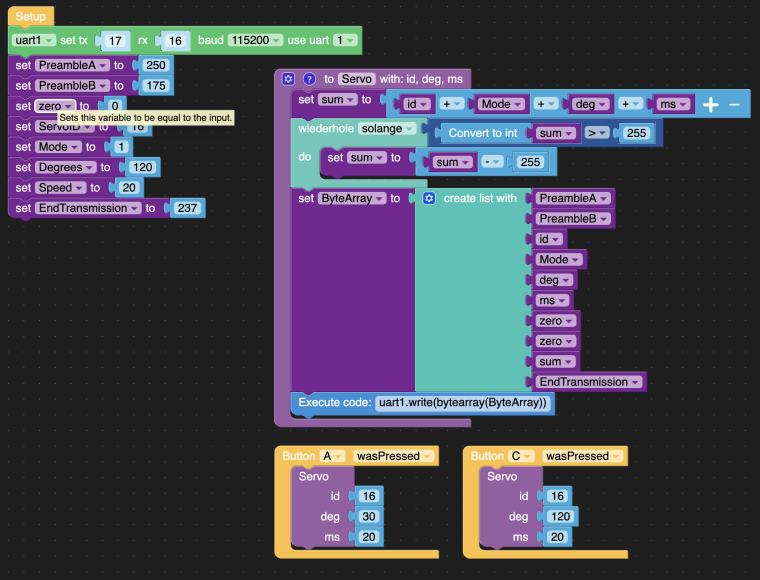

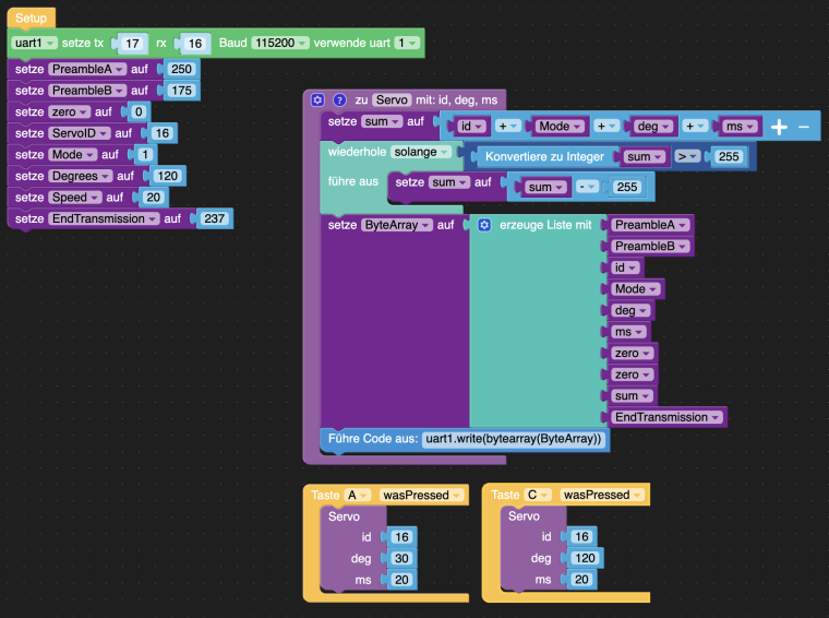

<p dir="auto">Uhh, sorry. Here the english version...</p>
<p dir="auto"><img src="/assets/uploads/files/1612533606629-bildschirmfoto-2021-02-05-um-14.59.10-resized.png" alt="0_1612533576762_Bildschirmfoto 2021-02-05 um 14.59.10.png" class=" img-fluid img-markdown" /></p>

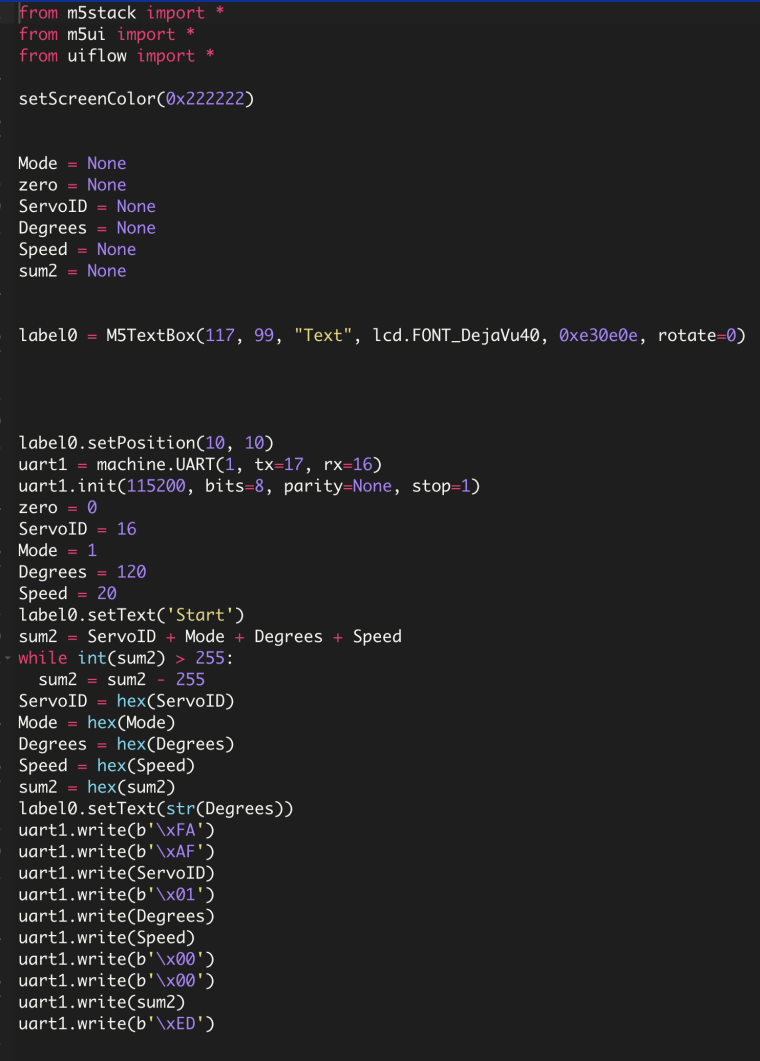

<p dir="auto">now it's work, with byte array...</p>
<p dir="auto"><img src="/assets/uploads/files/1612354744531-bildschirmfoto-2021-02-03-um-13.17.36-resized.png" alt="0_1612354729899_Bildschirmfoto 2021-02-03 um 13.17.36.png" class=" img-fluid img-markdown" /></p>

<p dir="auto">I think the problem is now with <code>uart1.write(ServoID)</code>. Eg. sending values from a variable. When I try this, the receiving end gets a string instead of the hex value.</p>
<p dir="auto">Unfortunately I am not a Python expert - I tried a few things but nothing seems to work. Sorry about that.</p>
<p dir="auto">Thanks<br />
Felix</p>

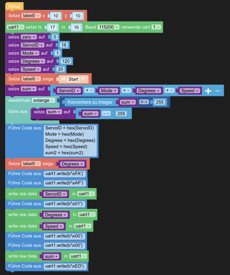

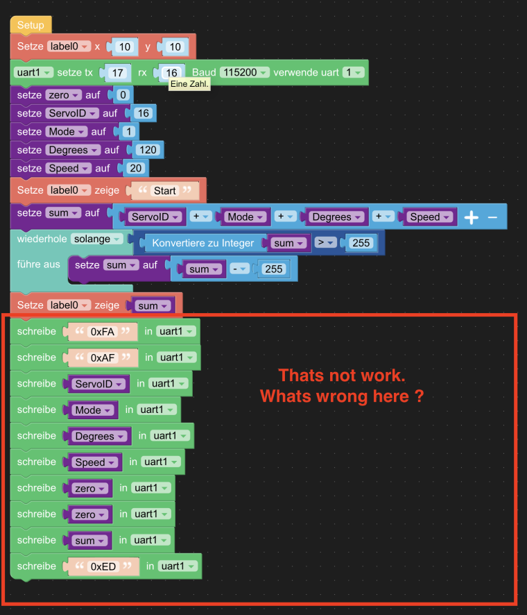

<p dir="auto">the block you are using actually writes a string "0xFA" but you want the raw hex value.</p>
<p dir="auto">I see two options:</p>
<ul>
<li>convert the hex values into decimal values, then use a UART - write raw data block or</li>
<li>try an Advanced - Execute code block with: <code>uart1.write(b'\xFA')</code></li>
</ul>
<p dir="auto">Note: untested as I don't have the required hardware.</p>
<p dir="auto">Good luck!<br />
Felix</p>
]]></description><link>https://community.m5stack.com/post/12255</link><guid isPermaLink="true">https://community.m5stack.com/post/12255</guid><dc:creator><![CDATA[felmue]]></dc:creator><pubDate>Tue, 02 Feb 2021 22:42:36 GMT</pubDate></item><item><title><![CDATA[Reply to Send AT Command va UIFlow on Tue, 02 Feb 2021 20:57:22 GMT]]></title><description><![CDATA[<p dir="auto">Hello,</p>

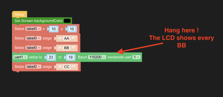

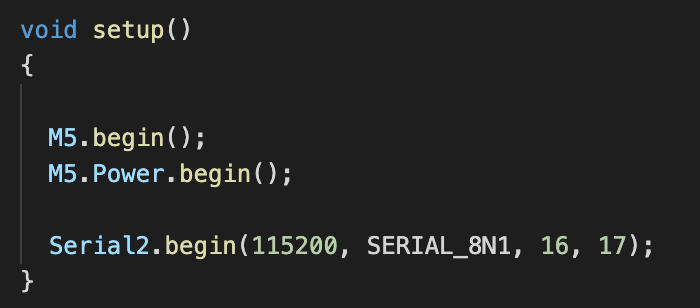

<p dir="auto">i have a M5Core device.</p>
<p dir="auto">Yes, i switch from TX23 -&gt; to TX17, and RX19 -&gt; to 16. Thanks for this tip.</p>

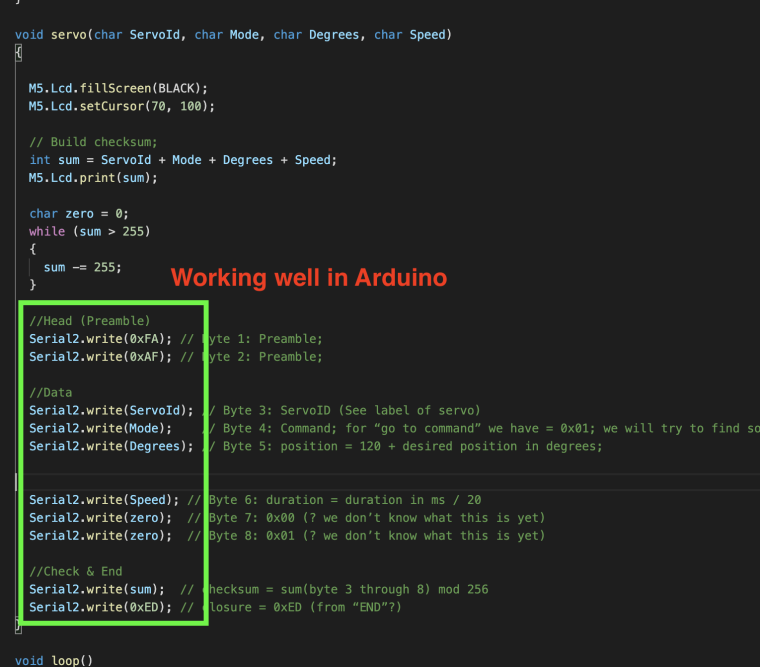

<p dir="auto">But, now i have a last question, see screenshot below.<br />
I Arduino i write with Serial2.write(...) the Hex. How can i do this in the UIFLOW ?!</p>
<p dir="auto">Please see screenshots...</p>
<p dir="auto"><img src="/assets/uploads/files/1612299399642-bildschirmfoto-2021-02-02-um-21.56.29.png" alt="0_1612299397255_Bildschirmfoto 2021-02-02 um 21.56.29.png" class=" img-fluid img-markdown" /></p>
<p dir="auto"><img src="/assets/uploads/files/1612299313132-bildschirmfoto-2021-02-02-um-21.49.45-resized.png" alt="0_1612299311469_Bildschirmfoto 2021-02-02 um 21.49.45.png" class=" img-fluid img-markdown" /></p>
<p dir="auto"><img src="/assets/uploads/files/1612299326197-bildschirmfoto-2021-02-02-um-21.53.36-resized.png" alt="0_1612299324520_Bildschirmfoto 2021-02-02 um 21.53.36.png" class=" img-fluid img-markdown" /></p>
<p dir="auto">Hope you can help me, with my last question...</p>

<p dir="auto">from your post it is not clear which device you are using? M5Stack (Fire, Gray, Basic), M5Core2, M5StickC (Plus), M5Atom, M5CoreInk, M5Paper? They all already use some GPIOs internally so there is a chance your choice (TX 23 / RX 19) creates some overlaps.</p>
<p dir="auto">For instance on M5Stack and M5Core2 GPIO23 is used for SPI MOSI already or M5StickC Plus has GPIO23 already in use for LCD_DC. So the reason 'BB' stays on your screen most likely is due to GPIO23 being repurposed for UART and by doing so cutting off the LCD.</p>

<p dir="auto"><img src="/assets/uploads/files/1612295956404-bildschirmfoto-2021-02-02-um-20.58.11-resized.png" alt="0_1612295953188_Bildschirmfoto 2021-02-02 um 20.58.11.png" class=" img-fluid img-markdown" /></p>
<p dir="auto">Whats wrong ??</p>
]]></description><link>https://community.m5stack.com/post/12251</link><guid isPermaLink="true">https://community.m5stack.com/post/12251</guid><dc:creator><![CDATA[TheAlphaGhost]]></dc:creator><pubDate>Tue, 02 Feb 2021 19:59:39 GMT</pubDate></item><item><title><![CDATA[Reply to Send AT Command va UIFlow on Fri, 22 Mar 2019 10:38:22 GMT]]></title><description><![CDATA[<p dir="auto"><a class="plugin-mentions-user plugin-mentions-a" href="/user/watson" aria-label="Profile: watson">@<bdi>watson</bdi></a> Thanks for the reply</p>

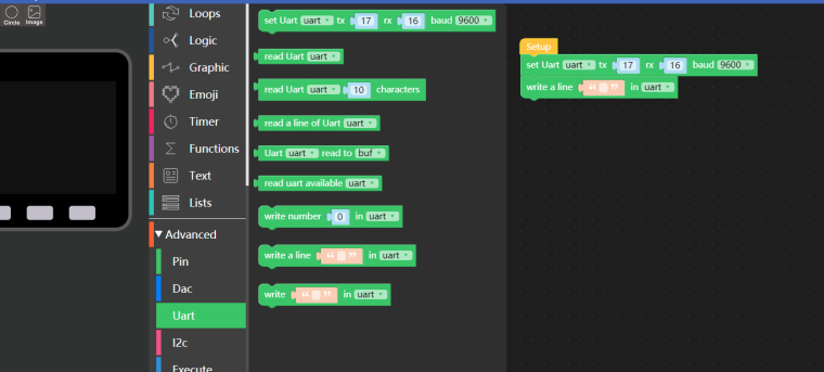

<p dir="auto">so I don't have to Street about the setup<br />
Serial2.begin(9600, SERIAL_8N1, 16, 17);</p>
<p dir="auto">Just use Uart and send command, Thanks with play around with it.</p>
]]></description><link>https://community.m5stack.com/post/3397</link><guid isPermaLink="true">https://community.m5stack.com/post/3397</guid><dc:creator><![CDATA[qlion]]></dc:creator><pubDate>Fri, 22 Mar 2019 10:38:22 GMT</pubDate></item><item><title><![CDATA[Reply to Send AT Command va UIFlow on Fri, 22 Mar 2019 07:11:28 GMT]]></title><description><![CDATA[<p dir="auto"><a class="plugin-mentions-user plugin-mentions-a" href="/user/qlion" aria-label="Profile: qlion">@<bdi>qlion</bdi></a> Explore it</p>
<p dir="auto"><img src="/assets/uploads/files/1553238675512-%E5%BE%AE%E4%BF%A1%E6%88%AA%E5%9B%BE_20190322151106-resized.png" alt="0_1553238676689_微信截图_20190322151106.png" class=" img-fluid img-markdown" /></p>
