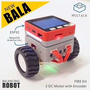

M5 Wheel of BALA is connected with M5Fire via pogo pin ( gpio21 gpio22 gnd 5v ).</p>
<p dir="auto">The IIC address of M5 Wheel ( 2-DC-driver module ) is 0x56.</p>
<p dir="auto"><img src="/assets/uploads/files/1554001295748-bala_1.jpg" alt="0_1554001286434_bala_1.jpg" class=" img-fluid img-markdown" /></p>
<p dir="auto"><a href="https://docs.m5stack.com/#/en/app/bala" target="_blank" rel="noopener noreferrer nofollow ugc">https://docs.m5stack.com/#/en/app/bala</a></p>
