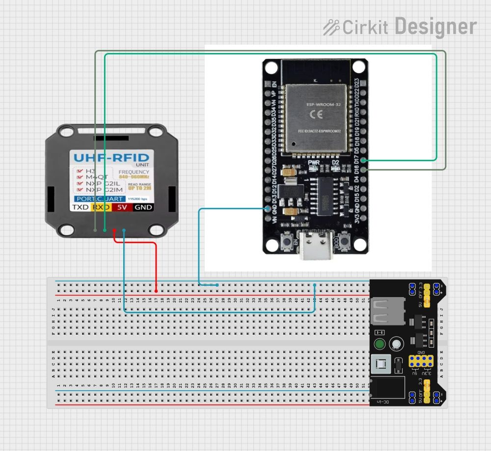

<p dir="auto">Second setup: External stable power supply (separate regulated source). (Circuit schema below)</p>
<p dir="auto">→ Reading distance improved to 40–50 cm</p>
</li>
</ul>
</li>
</ol>
<p dir="auto">This suggests that insufficient current may have been affecting performance initially. However, even with a dedicated external power source, the reading distance remains far below the expected range.</p>
