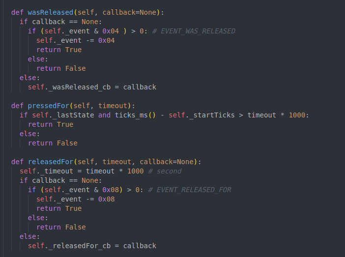

]]></description><link>https://community.m5stack.com/topic/815/interrupts</link><generator>RSS for Node</generator><lastBuildDate>Wed, 29 Apr 2026 06:21:55 GMT</lastBuildDate><atom:link href="https://community.m5stack.com/topic/815.rss" rel="self" type="application/rss+xml"/><pubDate>Fri, 29 Mar 2019 18:09:45 GMT</pubDate><ttl>60</ttl><item><title><![CDATA[Reply to Interrupts? on Sat, 30 Mar 2019 01:27:47 GMT]]></title><description><![CDATA[<p dir="auto"><a href="http://flow.m5stack.com" target="_blank" rel="noopener noreferrer nofollow ugc">flow.m5stack.com</a>， buttonA, B, C has been implemented using interrupts, or try:</p>
<pre><code>from m5stack import m5button
button = m5button.register(_BUTTON_PIN)
</code></pre>
<p dir="auto"><img src="/assets/uploads/files/1553909251570-074bc216-f4e2-4c8a-a9c3-b66a9e4d9064-image.png" alt="0_1553909250953_074bc216-f4e2-4c8a-a9c3-b66a9e4d9064-image.png" class=" img-fluid img-markdown" /></p>
