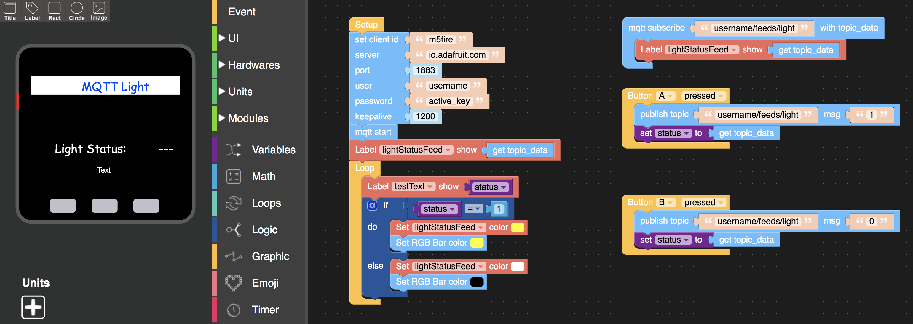

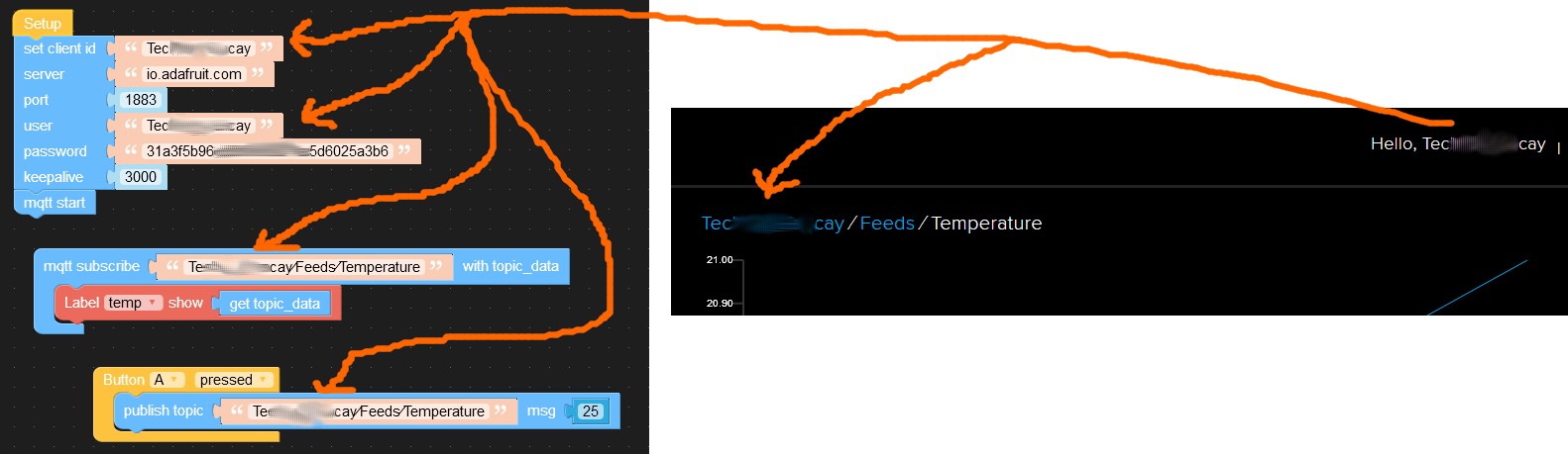

]]></description><link>https://community.m5stack.com/topic/826/mqtt-and-ui-flow-help-needed</link><generator>RSS for Node</generator><lastBuildDate>Wed, 29 Apr 2026 01:32:11 GMT</lastBuildDate><atom:link href="https://community.m5stack.com/topic/826.rss" rel="self" type="application/rss+xml"/><pubDate>Mon, 01 Apr 2019 13:48:49 GMT</pubDate><ttl>60</ttl><item><title><![CDATA[Reply to MQTT and Ui.Flow help needed on Mon, 08 Apr 2019 00:59:22 GMT]]></title><description><![CDATA[<p dir="auto">In your picture, the “/“ looks strange (it is touching the text) and not like mine. Perhaps you copied and pasted the feeds path from the Adafruit dashboard into UIFlow and it added some other character that looks like “/“ but is not truly a forward slash. Not entirely sure, but glad you got it working.</p>

I found issue in Python code.<br />
Thank you for help.</p>
]]></description><link>https://community.m5stack.com/post/3584</link><guid isPermaLink="true">https://community.m5stack.com/post/3584</guid><dc:creator><![CDATA[Techno86]]></dc:creator><pubDate>Sun, 07 Apr 2019 09:57:17 GMT</pubDate></item><item><title><![CDATA[Reply to MQTT and Ui.Flow help needed on Sat, 06 Apr 2019 20:34:29 GMT]]></title><description><![CDATA[<p dir="auto"><a class="plugin-mentions-user plugin-mentions-a" href="/user/techno86" aria-label="Profile: techno86">@<bdi>techno86</bdi></a> set Client ID is just a name for the client you are setting up. You can name it "client" (remove the quotes) if you want. User is your ID in Adafruit. Hope it is clear.</p>
]]></description><link>https://community.m5stack.com/post/3583</link><guid isPermaLink="true">https://community.m5stack.com/post/3583</guid><dc:creator><![CDATA[f3rn4nd0d]]></dc:creator><pubDate>Sat, 06 Apr 2019 20:34:29 GMT</pubDate></item><item><title><![CDATA[Reply to MQTT and Ui.Flow help needed on Sat, 06 Apr 2019 14:25:44 GMT]]></title><description><![CDATA[<p dir="auto">Hello<br />
I also have problems with Adafruit. I can't send temprature to my feed Temperature.<br />
What is the difference between "<strong>set client ID</strong>" and "<strong>User</strong>" in UIFlow mqtt block ?<br />
I join mt screeshot, maybe someone can tell me where is my mistake.<br />
Thanks.<br />
<img src="/assets/uploads/files/1554560704064-adafrui2t-resized.jpg" alt="0_1554560696951_adafrui2t.jpg" class=" img-fluid img-markdown" /></p>

]]></description><link>https://community.m5stack.com/post/3502</link><guid isPermaLink="true">https://community.m5stack.com/post/3502</guid><dc:creator><![CDATA[world101]]></dc:creator><pubDate>Wed, 03 Apr 2019 02:15:39 GMT</pubDate></item><item><title><![CDATA[Reply to MQTT and Ui.Flow help needed on Wed, 03 Apr 2019 02:12:55 GMT]]></title><description><![CDATA[<p dir="auto">This one worked for me in the past. The username and active_key can be found on the "View AIO Key" link on <a href="http://io.adafruit.com" target="_blank" rel="noopener noreferrer nofollow ugc">io.adafruit.com</a>. Make sure you have a feed named "light" set up under Feeds.</p>
<p dir="auto"><img src="/assets/uploads/files/1554257516430-screen-shot-2019-04-02-at-10.09.13-pm-resized.png" alt="0_1554257381294_Screen Shot 2019-04-02 at 10.09.13 PM.png" class=" img-fluid img-markdown" /></p>
