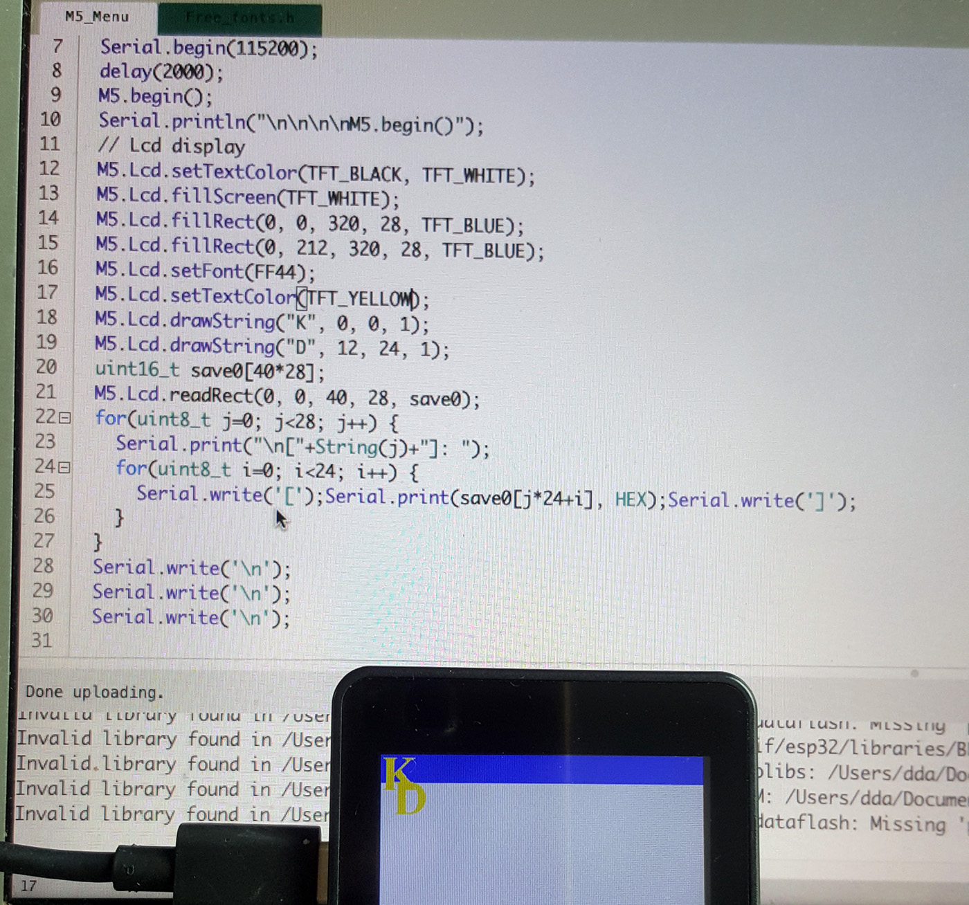

<p dir="auto">I've been implementing a menu system, and to be able to display the menu without destroying whatever was on the screen before, I am using M5.Lcd.readRect() to save parts of the screen in memory, to redraw later with M5.Lcd.pushRect().</p>
<p dir="auto">The problem is, it is currently not working. I could (almost) swear it worked a few days ago, but now when I call M5.Lcd.readRect(), all values are 0xFFFF...</p>
<p dir="auto"><img src="/assets/uploads/files/1517724198311-20180204_135355-resized.jpg" alt="0_1517724186126_20180204_135355.jpg" class=" img-fluid img-markdown" /></p>
<p dir="auto">As you can see, there's plenty of blue and yellow (ugly I know, but I need to make sure!) in the top left corner. But the printout of save0 gives me this:</p>

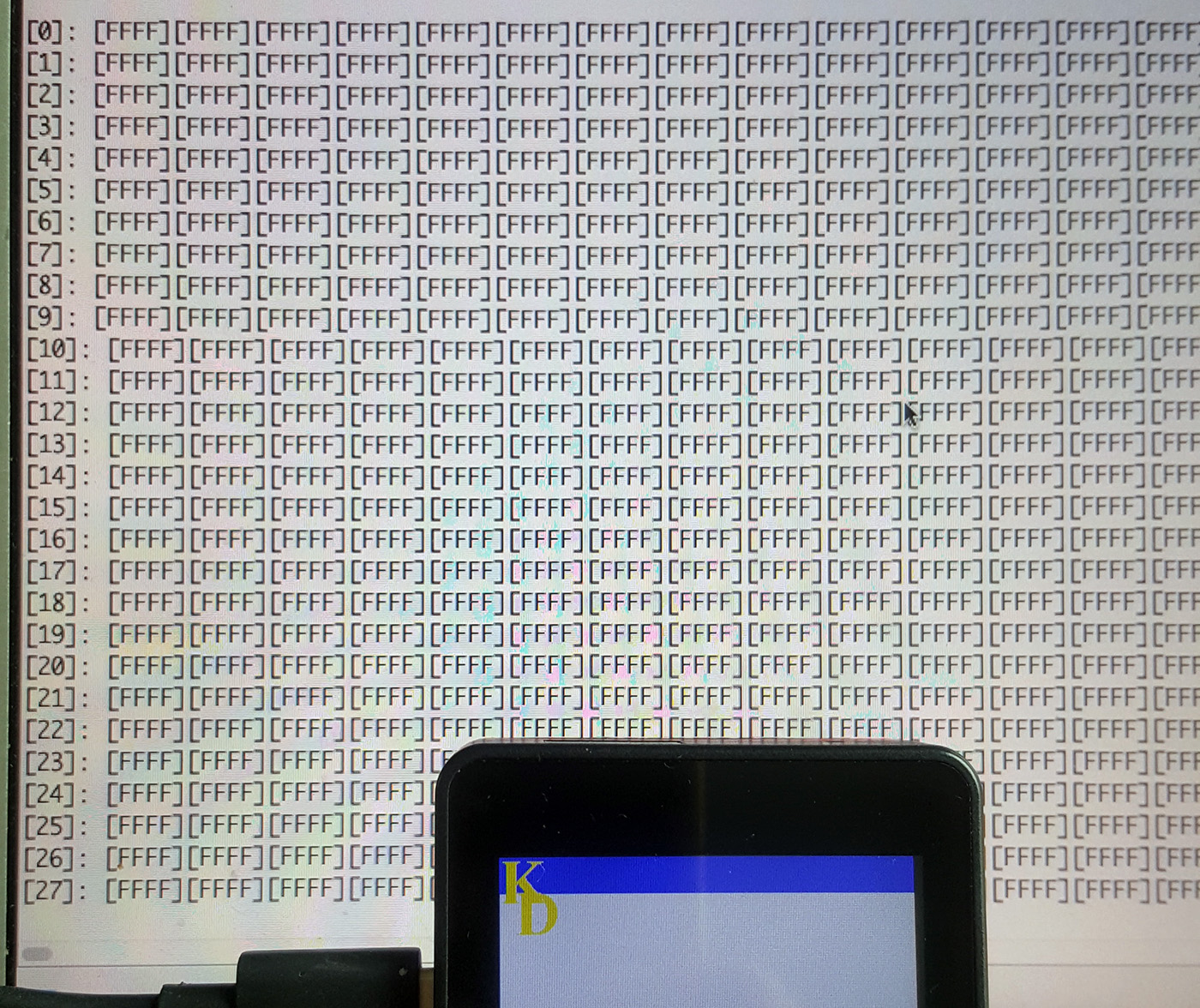

<p dir="auto"><img src="/assets/uploads/files/1517724292070-20180204_135435-resized.jpg" alt="0_1517724276887_20180204_135435.jpg" class=" img-fluid img-markdown" /></p>
<p dir="auto">All pixels are 0xFFFF... What am I missing here?</p>

]]></description><link>https://community.m5stack.com/post/301</link><guid isPermaLink="true">https://community.m5stack.com/post/301</guid><dc:creator><![CDATA[dda]]></dc:creator><pubDate>Sun, 04 Feb 2018 09:24:12 GMT</pubDate></item><item><title><![CDATA[Reply to Problem with M5.Lcd.readRect on Sun, 04 Feb 2018 08:31:51 GMT]]></title><description><![CDATA[<p dir="auto">LCD hardware is not connect the miso pin, sorry next version will remove it.</p>
]]></description><link>https://community.m5stack.com/post/300</link><guid isPermaLink="true">https://community.m5stack.com/post/300</guid><dc:creator><![CDATA[0x1abin]]></dc:creator><pubDate>Sun, 04 Feb 2018 08:31:51 GMT</pubDate></item></channel></rss>
