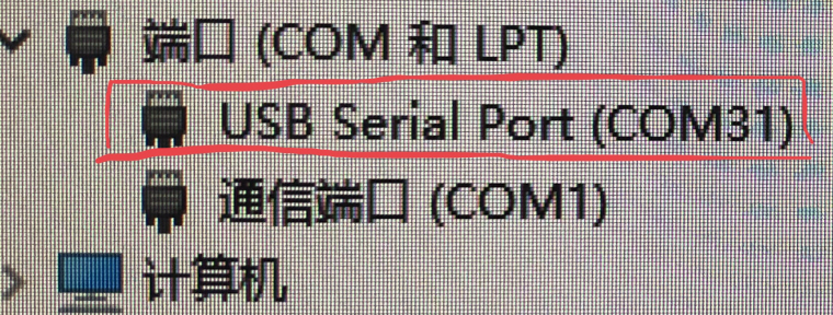

]]></description><link>https://community.m5stack.com/post/3534</link><guid isPermaLink="true">https://community.m5stack.com/post/3534</guid><dc:creator><![CDATA[m5stack]]></dc:creator><pubDate>Thu, 04 Apr 2019 06:22:10 GMT</pubDate></item><item><title><![CDATA[Reply to M5StickC driver no work on Thu, 04 Apr 2019 06:08:19 GMT]]></title><description><![CDATA[<p dir="auto"><a class="plugin-mentions-user plugin-mentions-a" href="/user/kosterok" aria-label="Profile: kosterok">@<bdi>kosterok</bdi></a> M5StickC displayed like this picture on my PC.<br />
<img src="/assets/uploads/files/1554357000895-img_3108-resized.jpg" alt="0_1554356977917_IMG_3108.jpg" class=" img-fluid img-markdown" /><br />
Please check it again.</p>
<p dir="auto">That stop work problem is not hardware problem.<br />
Old version factory firmware have this problem.<br />
Please try to burn new FactoryTest example with Arduino IDE.<br />
(you need to install M5StickC library)</p>
<p dir="auto">thank you.</p>
