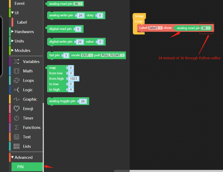

<p dir="auto">meanwhile it is possible to use the block "analog read pin (34)" from the blockpack "Easy I/O".<br />
So I was able to bild the probram from user M5DOCS just with UIFLOW.</p>
<p dir="auto">Unfortunally it just shows Numbers between 450 and 600 or so. And it dows not react to any sounds.</p>
<p dir="auto">This is the python code of the blockly program:</p>

<p dir="auto"><img src="/assets/uploads/files/1555067638397-%E5%BE%AE%E4%BF%A1%E6%88%AA%E5%9B%BE_20190412191332-resized.png" alt="0_1555067637519_微信截图_20190412191332.png" class=" img-fluid img-markdown" /></p>
<p dir="auto"><img src="/assets/uploads/files/1555067647100-%E5%BE%AE%E4%BF%A1%E6%88%AA%E5%9B%BE_20190412191202.png" alt="0_1555067647948_微信截图_20190412191202.png" class=" img-fluid img-markdown" /></p>
]]></description><link>https://community.m5stack.com/post/3695</link><guid isPermaLink="true">https://community.m5stack.com/post/3695</guid><dc:creator><![CDATA[m5-docs]]></dc:creator><pubDate>Fri, 12 Apr 2019 11:14:57 GMT</pubDate></item><item><title><![CDATA[Reply to [Solved]M5fire read microphone on Fri, 05 Apr 2019 01:20:42 GMT]]></title><description><![CDATA[<p dir="auto"><a class="plugin-mentions-user plugin-mentions-a" href="/user/hetzer" aria-label="Profile: hetzer">@<bdi>hetzer</bdi></a><br />
