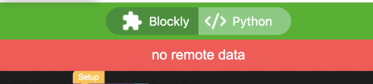

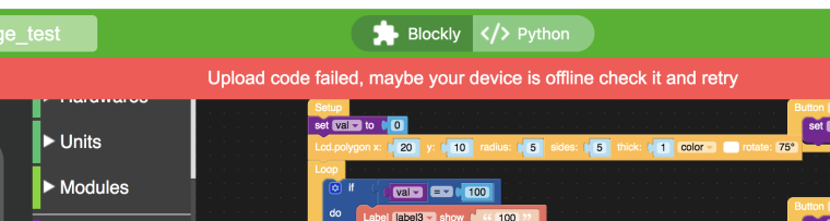

<?xml version="1.0" encoding="UTF-8"?><rss xmlns:dc="http://purl.org/dc/elements/1.1/" xmlns:content="http://purl.org/rss/1.0/modules/content/" xmlns:atom="http://www.w3.org/2005/Atom" version="2.0"><channel><title><![CDATA[[Solved]uiFlow has been really buggy lately]]></title><description><![CDATA[<p dir="auto">uiFlow has been really buggy lately. I constantly get errors when trying to run or download my programs to the m5stack Fire and m5stick-C. It seems like I have to press the run button 3 to 4 times before it is successful. Is there anything going on with the uiFlow cloud servers?</p>
<p dir="auto">I get these errors, even though my device is connected before pressing the Run button in uiFlow. It seems to disconnect my device very often.<br />
<img src="/assets/uploads/files/1555244923233-screen-shot-2019-04-14-at-7.25.07-am-resized.png" alt="1_1555244917161_Screen Shot 2019-04-14 at 7.25.07 AM.png" class=" img-fluid img-markdown" /> <img src="/assets/uploads/files/1555244923037-screen-shot-2019-04-14-at-7.24.59-am-resized.png" alt="0_1555244917161_Screen Shot 2019-04-14 at 7.24.59 AM.png" class=" img-fluid img-markdown" /></p>
<p dir="auto">When I use the Download option within uiFlow, it also fails sometimes as well. The m5stack will display Uploading... and then seems to hang. If I wait about 30-45 seconds and then reset the m5stack, only sometimes the program will actually be downloaded to my device.</p>
<p dir="auto">Anyone else seeing the same thing?</p>

]]></description><link>https://community.m5stack.com/post/4071</link><guid isPermaLink="true">https://community.m5stack.com/post/4071</guid><dc:creator><![CDATA[m5-docs]]></dc:creator><pubDate>Tue, 30 Apr 2019 13:02:53 GMT</pubDate></item><item><title><![CDATA[Reply to [Solved]uiFlow has been really buggy lately on Mon, 15 Apr 2019 05:38:52 GMT]]></title><description><![CDATA[<p dir="auto"><a class="plugin-mentions-user plugin-mentions-a" href="/user/watson" aria-label="Profile: watson">@<bdi>watson</bdi></a> said in <a href="/post/3754">uiFlow has been really buggy lately</a>:</p>
<p dir="auto">UIFlow server is in Singapore. So the network is not very stable. Before click RUN or Download, please check here for core being connected succesfully.<br />
<img src="/assets/uploads/files/1555295268367-%E5%BE%AE%E4%BF%A1%E6%88%AA%E5%9B%BE_20190415102739.png" alt="0_1555295268276_微信截图_20190415102739.png" class=" img-fluid img-markdown" /></p>
<p dir="auto">And here I was thinking that it was just me.</p>
<p dir="auto">Looks system wide.</p>
