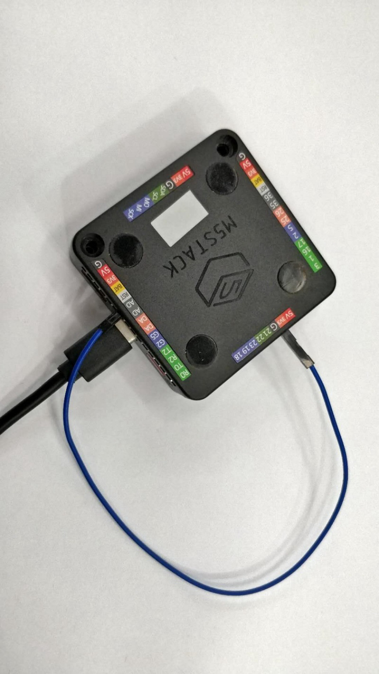

<p dir="auto">The hardware file if BLACK is same as GRAY expect that GRAY OWNS  mpu9250.<br />
So if the BUTTON Unit works weith GRAY, it wil also work with BLACK.<br />
You can check the G36 on BLACK by reading the level of G36 after G36 attached to 3.3V pin.</p>
<p dir="auto"><img src="/assets/uploads/files/1555925458537-%E5%BE%AE%E4%BF%A1%E5%9B%BE%E7%89%87_20190419163740-resized.jpg" alt="0_1555925445994_微信图片_20190419163740.jpg" class=" img-fluid img-markdown" /></p>
