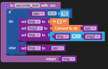

<p dir="auto">So this worked, because I needed numbers</p>
<p dir="auto"><img src="/assets/uploads/files/1556125587733-6003dc45-9bfc-4278-9a73-471038e6a730-image.png" alt="0_1556125589289_6003dc45-9bfc-4278-9a73-471038e6a730-image.png" class=" img-fluid img-markdown" /></p>
<p dir="auto">Would you mind if I added this to my book?</p>
