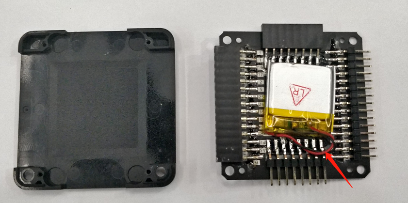

]]></description><link>https://community.m5stack.com/post/4180</link><guid isPermaLink="true">https://community.m5stack.com/post/4180</guid><dc:creator><![CDATA[DavMartEs]]></dc:creator><pubDate>Tue, 07 May 2019 16:21:47 GMT</pubDate></item><item><title><![CDATA[Reply to [Solved]Disable battery on Mon, 06 May 2019 01:41:55 GMT]]></title><description><![CDATA[<p dir="auto"><a class="plugin-mentions-user plugin-mentions-a" href="/user/davmartes" aria-label="Profile: davmartes">@<bdi>davmartes</bdi></a> According to the following pictures, you can cut off the red cable of Battery</p>

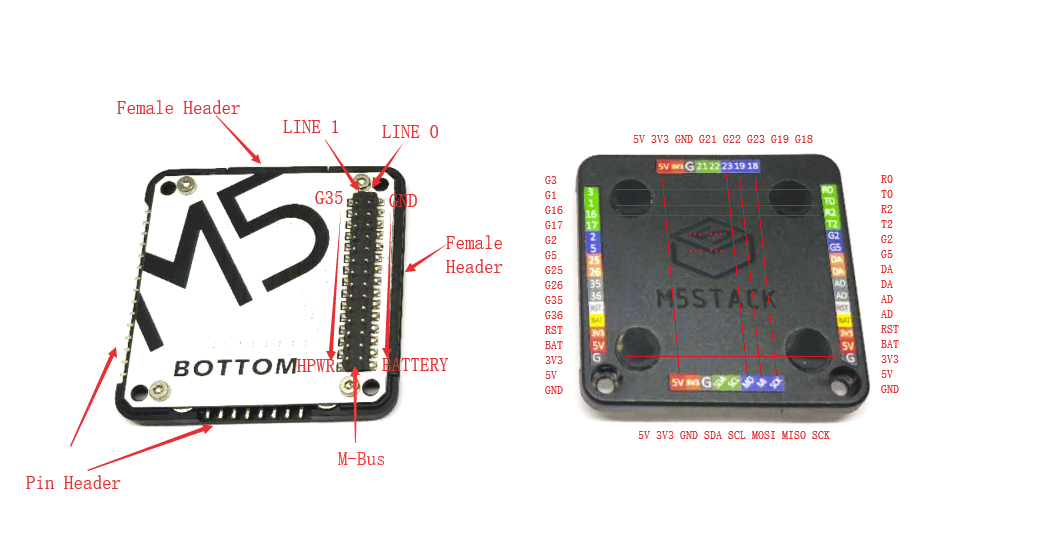

<p dir="auto"><img src="/assets/uploads/files/1557106875969-%E5%BE%AE%E4%BF%A1%E6%88%AA%E5%9B%BE_20190506093533-resized.png" alt="0_1557106874171_微信截图_20190506093533.png" class=" img-fluid img-markdown" /></p>

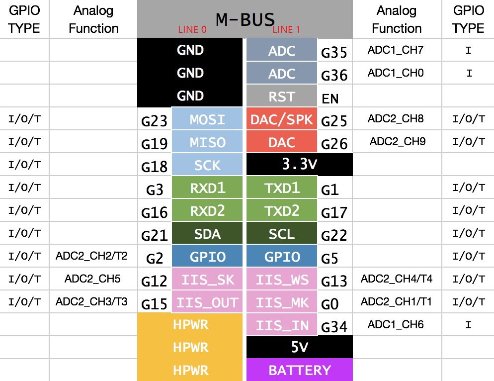

<p dir="auto">or cur off the pin named "BATTERY" on M5-Bus</p>
<p dir="auto"><img src="/assets/uploads/files/1557106905604-core_base_05-resized.png" alt="0_1557106903942_core_base_05.png" class=" img-fluid img-markdown" /></p>
<p dir="auto">M5-Bus</p>
