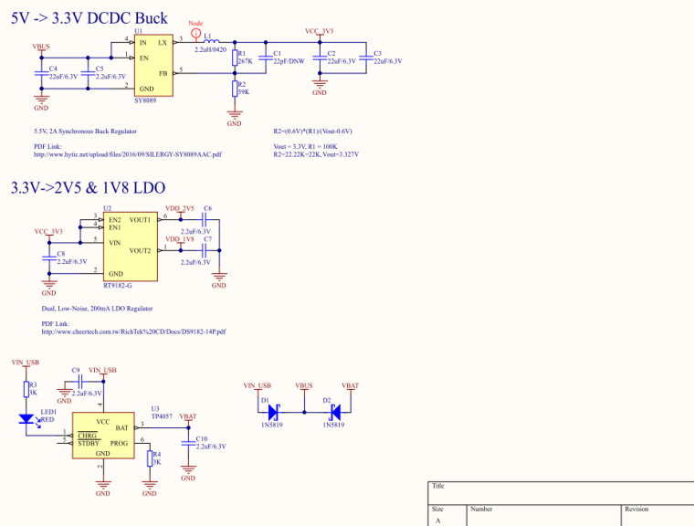

]]></description><link>https://community.m5stack.com/topic/981/solved-esp32cam-3-3v</link><generator>RSS for Node</generator><lastBuildDate>Tue, 28 Apr 2026 23:55:41 GMT</lastBuildDate><atom:link href="https://community.m5stack.com/topic/981.rss" rel="self" type="application/rss+xml"/><pubDate>Sun, 05 May 2019 14:30:36 GMT</pubDate><ttl>60</ttl><item><title><![CDATA[Reply to [Solved]ESP32CAM 3.3v on Tue, 07 May 2019 01:19:09 GMT]]></title><description><![CDATA[<p dir="auto"><a class="plugin-mentions-user plugin-mentions-a" href="/user/lurk_" aria-label="Profile: lurk_">@<bdi>lurk_</bdi></a> Because there are SY8089, RT9182 chip between BAT pin and ESP32_VCC, in order to transfer high voltage to 3.3V.</p>
<p dir="auto">So you need a battery with higher voltage capacity.</p>
<p dir="auto"><img src="/assets/uploads/files/1557191946778-m5camera_sch_01-resized.png" alt="0_1557191947449_m5camera_sch_01.png" class=" img-fluid img-markdown" /></p>

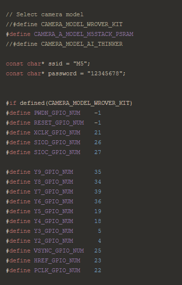

<p dir="auto">If you want ESP32CAM to work, need to change this code for being Suitable for ESP32CAM.</p>
<p dir="auto"><img src="/assets/uploads/files/1557115245687-%E5%BE%AE%E4%BF%A1%E6%88%AA%E5%9B%BE_20190506120031.png" alt="0_1557115243742_微信截图_20190506120031.png" class=" img-fluid img-markdown" /></p>
<p dir="auto">Refer to what the <a href="http://README.md" target="_blank" rel="noopener noreferrer nofollow ugc">README.md</a> told</p>
<p dir="auto"><a href="https://github.com/m5stack/m5stack-cam-psram" target="_blank" rel="noopener noreferrer nofollow ugc">https://github.com/m5stack/m5stack-cam-psram</a></p>
