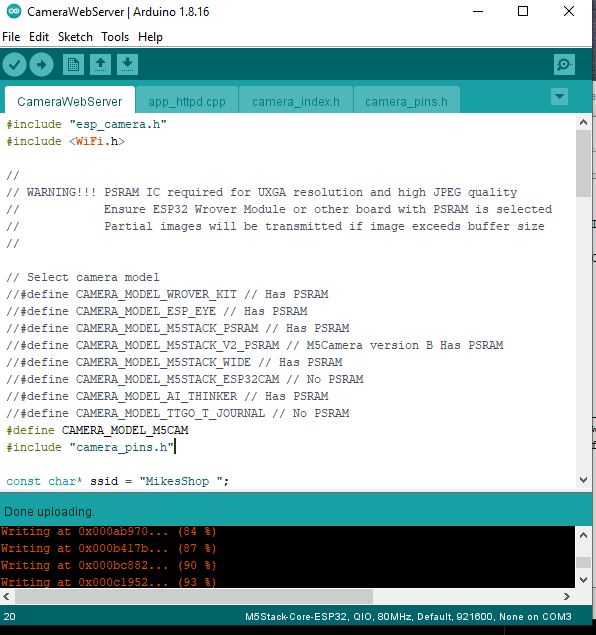

<p dir="auto">If I use m5burner and flash the  espcam-nopsram, I can connect and see video, so hardware is good.</p>
<p dir="auto">I added the esp32 board support from here:<br />
<a href="https://github.com/espressif/arduino-esp32/blob/master/docs/arduino-ide/boards_manager.md" target="_blank" rel="noopener noreferrer nofollow ugc">https://github.com/espressif/arduino-esp32/blob/master/docs/arduino-ide/boards_manager.md</a></p>
<p dir="auto">But then, Arduino,Tools,Board: does not have anything that seems like ESP32CAM.</p>
<p dir="auto">Has Anybody managed to get the ESP32CAM unit to show video in Arduino? Or is this not really working?</p>

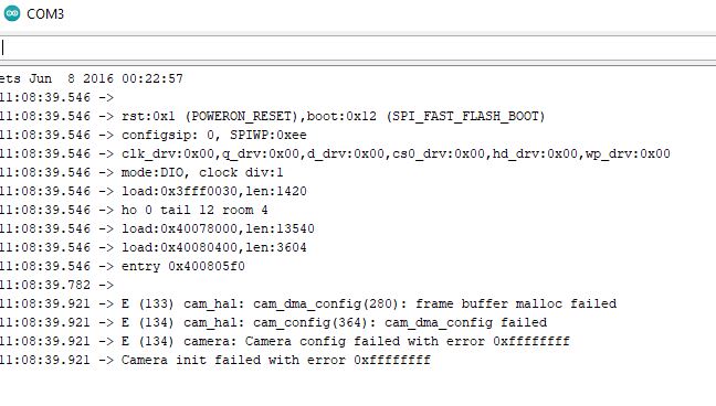

<p dir="auto">About old versions of ESP32-Arduino on Arduino IDE...</p>
<p dir="auto">Yes, it is possible and EASY to install old versions...</p>
<p dir="auto">This official guide describe how to install the current version:<br />
<a href="https://docs.espressif.com/projects/arduino-esp32/en/latest/installing.html" target="_blank" rel="noopener noreferrer nofollow ugc">https://docs.espressif.com/projects/arduino-esp32/en/latest/installing.html</a></p>
<p dir="auto">The only change needed is to download a diffent/old version of the code...</p>
<p dir="auto">I did a test going back to 2021/FEB/23, and it WORKS!<br />
(This is the same day I had choosed to test ESP32-camera software for the ESP-IDF,<br />
so, I was hoping that it was OK for Arduino IDE setup as well...)</p>
<p dir="auto">Besides this bug being just a temporary stuff, I will document better how to use old versions of code, for IDF and for Arduino IDE, because there are probably MANY situations in which we would like to use/test different versions other than the current version...</p>
<p dir="auto">Regards,<br />
Valter</p>

<p dir="auto">hi,<br />
I also experienced the same kind of error trying a M5Stack UnitCam (no PSRAM), using Arduino IDE Platform.</p>
<p dir="auto">Here is the error msg:</p>
<pre><code>E (127) cam_hal: cam_dma_config(280): frame buffer malloc failed
E (127) cam_hal: cam_config(364): cam_dma_config failed
E (127) camera: Camera config failed with error 0xffffffff
Camera init failed with error 0xffffffff
</code></pre>
<p dir="auto">I found that there is a bug on the "esp32-camera" software, which is preventing the code to correctly work on devices WITHOUT PSRAM!<br />
See the issue here:<br />
<a href="https://github.com/espressif/esp32-camera/issues/334" target="_blank" rel="noopener noreferrer nofollow ugc">https://github.com/espressif/esp32-camera/issues/334</a></p>
<p dir="auto">In the case of the UnitCam, I was able to confirm that going back to 2021/FEB code (esp32-camera), it works perfectly, without problems, on ESP-IDF Dev Framework...<br />
So, now I have it working OK.</p>
<p dir="auto">I believe that this is the reason why the Arduino IDE Framework also fails for the UnitCam (and also, for any other CAM without PSRAM), since it is probably using the latest version of the code, which have the bug in it...</p>
<p dir="auto">I don't know how to "install" the old version of the esp32-camera on the Arduino IDE, besides I am asking myself if this is possible/easy to do, because I do have interest in using it with Arduino IDE as well...</p>
<p dir="auto">I will post more infos regarding the UnitCam and this bug later...</p>
<p dir="auto">The bug itself does not seems to be difficult to resolve, so, hopefully the solution will come in the next few days...</p>
<p dir="auto">So, the example inside the Arduino IDE and all the other tutorials/samples that exist on the Internet, probably WORKS OK on devices without PSRAM... what is causing the trouble is the bug introduced this year (2021) on the code, code that was OK in the past months/years...</p>
<p dir="auto">Hope it can help,<br />
Valter</p>
