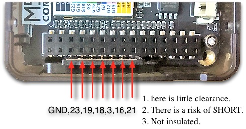

            Hello @kazyam53
            M5Stack Basic V2.6
            There is a small clearance between the M-BUS and the metal surface on the back of the Speaker, and some are in contact with each other.
            There is a risk of short circuit of M-BUS (GND, 23,19,18,3,16,21).
            • felmueF Online
              felmue
              Hello @macsbug
              I've noticed that too. However there is insulation (capton tape) on the back of the speaker in my M5Stack base v2.6.
              Thanks
              Felix
