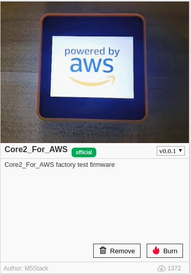

          Hello @W4GHV
          Core2_For_AWS is a firmware binary in M5Burner as well. No need to compile anything. (Note: it's listed under CORE and not CORE2 & TOUGH.)
          As for the AT608A error. Since the AT08A is in the M5GO battery bottom 2 - did you try this with the M5GO battery bottom stacked?
          The only other idea I have, if you haven't tried that yet, is to use M5Burner to completely erase your M5Core2 before burning a new firmware.

                      Hello @W4GHV
                      have you downloaded the Core2_For_AWS from within M5Burner?
                      In my Linux setup Core2_For_AWS-v0.0.1.bin is in this path M5Burner_Linux/packages/fw/core/.
                      Thanks
                      Felix
