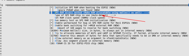

      • H Offline
        heybin
        please choose psram size to 4MB0_1559292247701_bcc73ad7-e101-43f8-b252-3361553b63a6-image.png
        • M Offline
          MartaRho
          Thanks @heybin ! That worked well (and it was surprisingly easy :) )
